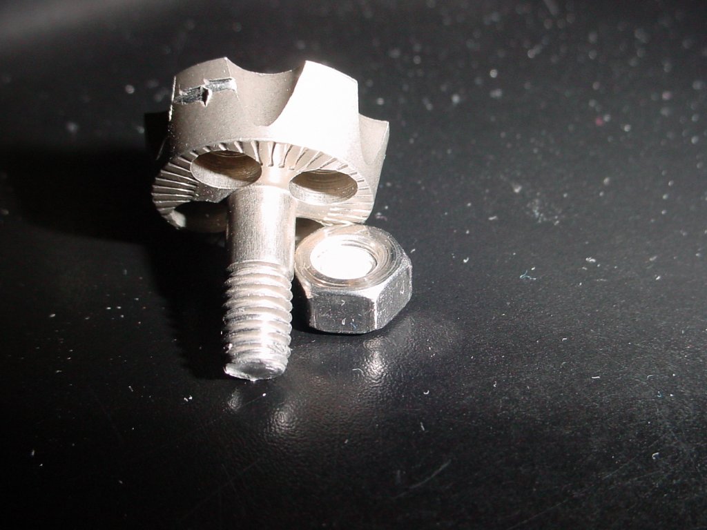

Makes sure that the stem on the motor adapter does not have and grit or sand gains in the threads before trying to remove that nut or this will happen. And I only like another 5% have the gains set on my 810 also.

I cannot tell for sure, but your threads also look a little deformed so the nut could have simply got stuck on the threads. Dirt, Smashed Threads, Bad luck, the outcome is all the same. The prop cones are terrible for staying on (not a lock nut) and usually cannot use a wrench of any kind, but they do help protect your threads in a crash :D.
Make sure you aren't cranking too hard as well when tightening the props. These aluminum prop adapters can only handle so much so many times.
But yea, carry an extra tooth brush or gun cleaning brush and if you cake your threads with dirt, give them a quick scrubbing to remove the dirt. If the threads are smashed, you could probably run a die down the threads to reform them enough to allow the nut to come off without snapping the stem as well. But I wouldn't carry a tap and die set, I don't even have one :D.
If it makes you feel better, I have done that to steel bolts when using too big of a wrench, too much torque and the metal simply twists off as you see there.

The deformed part I think is about where the grit started and I tried to reverse the nut but no luck it was too late. The aluminum is way too soft for prop adapters they should at least be air craft aluminum or a heat treated type aluminum. And I really hate the "Cone" nuts I have lost more of them than I can count.
