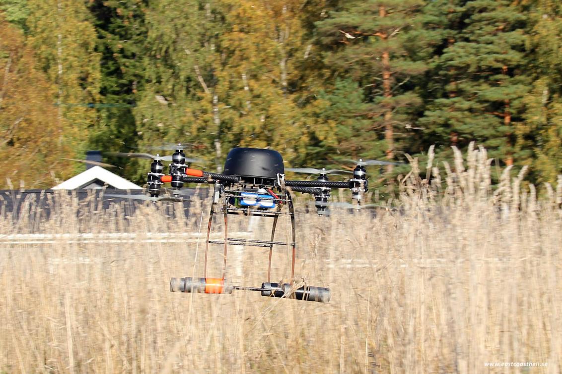

FC 0.86c and NC 0.26e. It's a job to keep up with all the changes ATM. As I said It's great flying weather in ye old Essex today so will report any problems - if any later on.
I took these yesterday on the older .86 and she handled vey well
attachment.php
attachment.php
I'm flying with FC 0.86c and NC 0.26e.
No issues then? would you recommend the upgrade.
Nice pic what props? I find my Graupners are great for strimming!
What dome is that? is it a DW ADX4?
