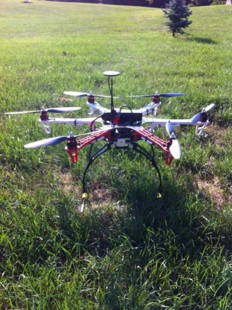

Not homemade but ........
At the price of the one i bought from quadframe.com (38 euros) I couldn't see the point in making any, and they work great. At the time they didnt have a specific fitting kit for my 550 so I had a bit of messing to do, but overall I am extremely happy with them.

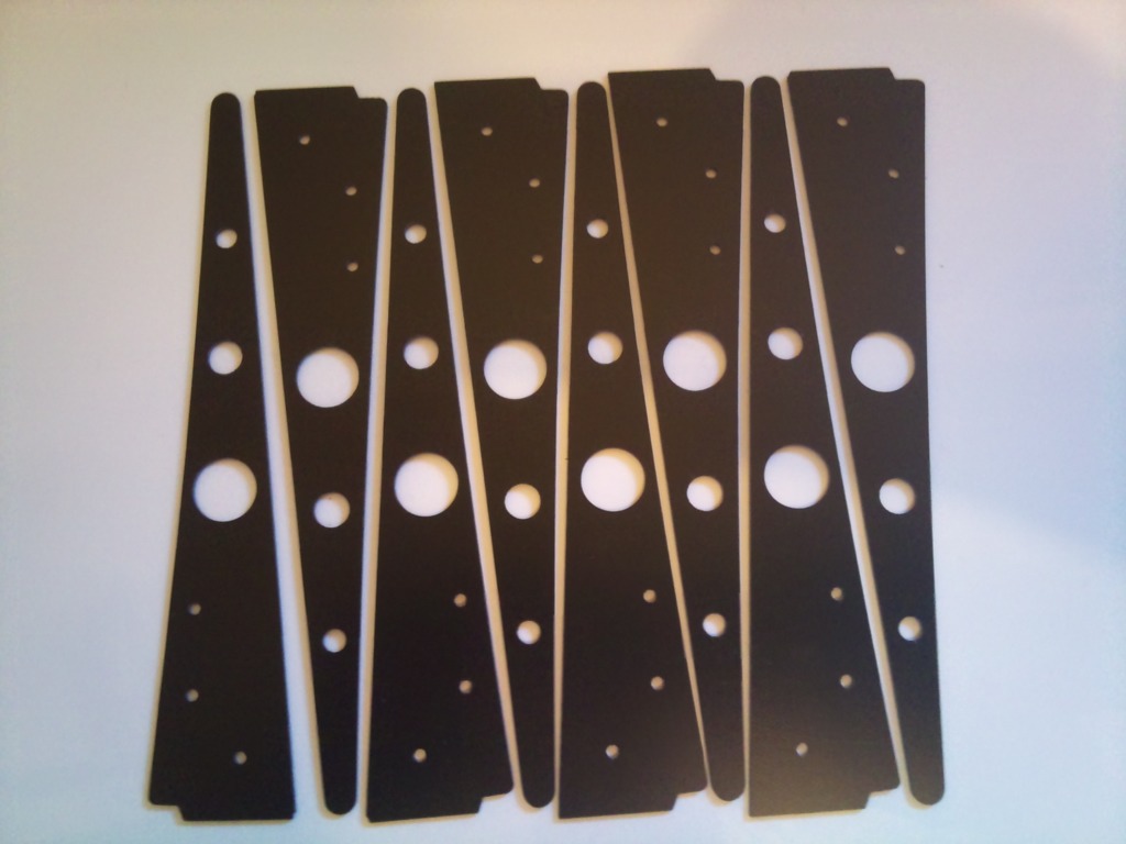

Thinking of getting 2 batwings for the PoPro and battery.
I still want to keep the F450 as close as possible to the ground and the smaller the legs the better. Can you make shorter legs just to have the waterproof case clear the ground by 1/4" or so ?
Also, I have my GoPro mounted directly to the distribution board on a piece of sorbothane and a velcro strap holding the GoPro on. I get pretty much zero vibrations and no jello.
Does having the batwing ziptied to the 2 arms make a pretty rigid joint and should still give vibration free video from my F450?
DucktileMedia
You can just cut down the legs yourself. It would certainly be a lot cheaper than having me run a custom program. Yes, the zip ties hold the batwing very rigidly.
