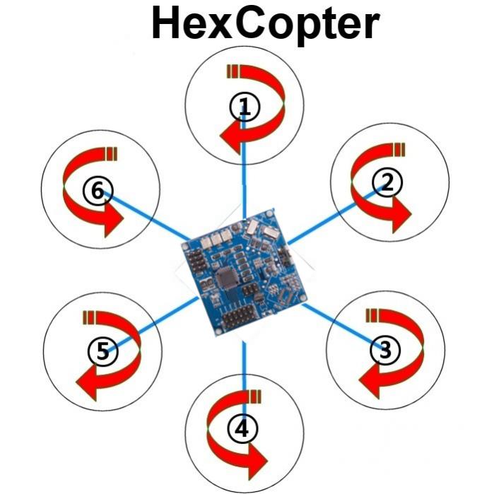

Hi, I,m new toi hexa copters, bought a frame from China, the KK board arrow points between two of the motors, does this need to change? Also the hex spins, I have checked the props and motor direction, any ideas? I have only done a few hops as it spins like a top! Thanks MAtthew

The outer blade of motor 1 rotates to the right, the outer blade of motor 2 rotates left etc.

Hi Pete, It's a hexacopter and the arrow points between 1 and 2. As the arrow doesn't point to 1, wondered if this is why it was so difficult to fly?

The white arrow points straight forward - to the front of the copter. Straight at motor#1. Not the way it is shown in your hexa photo.

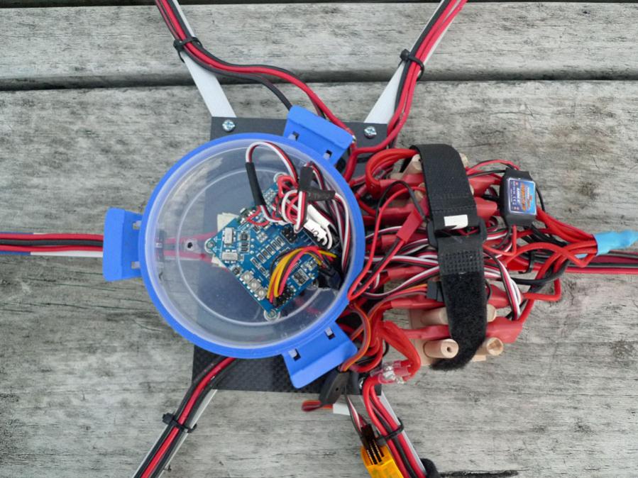

Here was my first hexa.

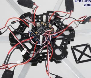

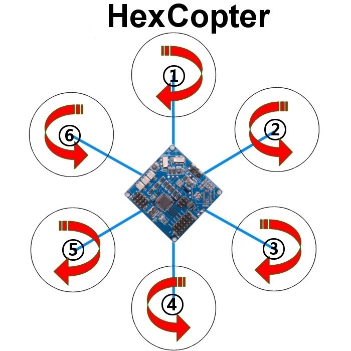

View attachment 9400 Hi, This if from the instructions, difficult to see but points exactly between the legs, I'll get the drill out, thanks for your help. Matthew
