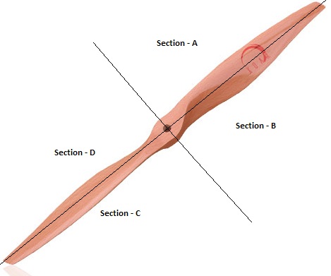

Theoretically (assuming one got enough time and patience) you should first balance the motor without props.....than balance the props with a balancer as close as possible. After that mount the props and measure again.....After doing that myself and some playing arround I found out that - if you have to add weight to the props to balance them - it not only depends on how much weight (tape, glue, nail polish.....) you take, it also depends where you add that weight on the prop. If you take a prop and think a line along it's
blades and than think another line in 90° through the center of the hub, you get 4 "sectors" A,B,C and D....look at the picture:
Since the prop is a 3-dimensional structure, A and B have a different weight. A should be equally heavy (counterbalanced) with C, and B should be equally heavy D. If you balance your props horizontally (blade tips left and right) you normally stick some weight on the lighter side until left and right is in balance....and think "ok...now it's balanced....". If you turn the props in a horizontal position (blade tips up and down) one side might tend to fall to the left or to the right....and than the nonsens with "hub balancing" starts. People glue velcro tape and all sorts of rubbish to the hub and wonder how much weight they need to see any affect. In most cases the hub is not out of balance (sometimes it is) but the weight distribution on all 4 sectors is somewhere out of balance, and even sticking weight during horizontal balancing might add to that. To check the hub you just need a cheap digital caliper to measure the hub. It would have to be really out of measurement to have an affect on your vertical balance. Even if the prop is horizontally perfectly in balance out of the box, you might have to stick equal weights on both blades (in different locations on the blade) to get it vertically balanced as well. As sad as it is, but I have not found a way other than trial and error....and it's a freaking pain in the butt.
