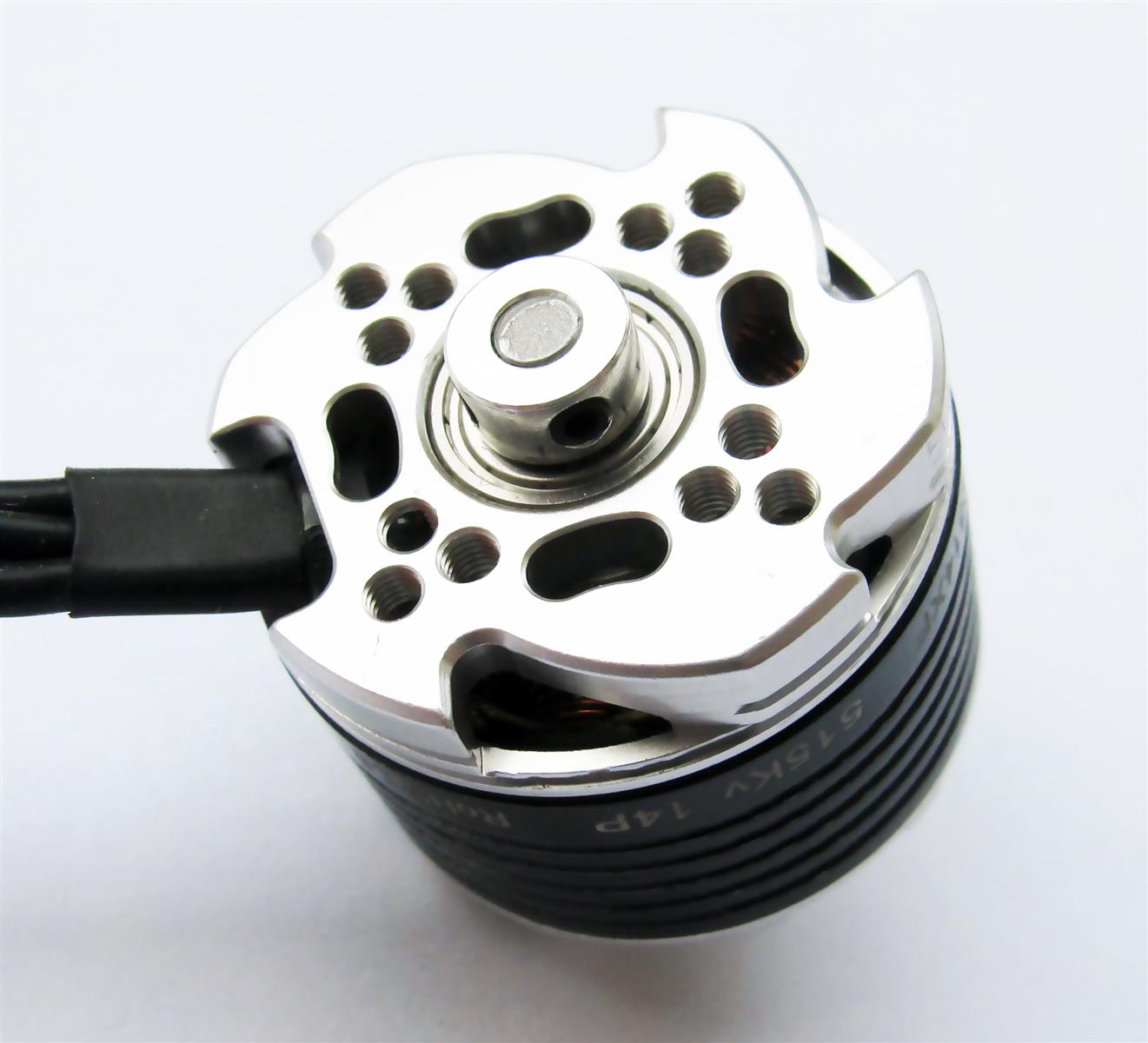

I did not make the best choice on the motors as I did not realize it was better to get the KV down when using larger diameter props. But more recently I went down the following path....
http://www.hobbyking.com/hobbyking/..._4822_570Kv_22Pole_Multi_Rotor_Outrunner.html
Use eCalc for Multirotors to get it all right the first time or be prepared to own some mismatched items etc.

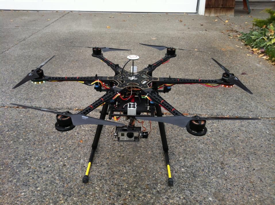

Eventually I ended up with my F550 converted up to the following 800mm motor arm length to handle much larger props for greater efficiency.... The 800mm airframe cost me only $65!!!:View attachment 17770
