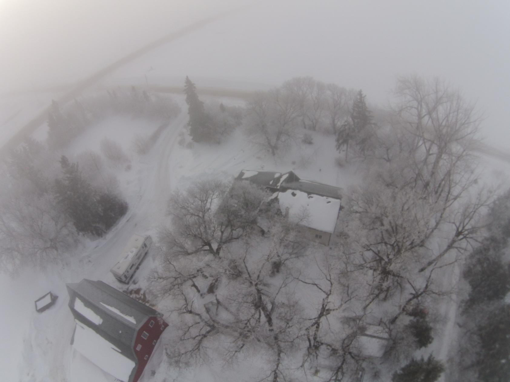

Took this picture of the beautiful horror frost this morning with the Phantom 2 Vision from about 120'. Then I came down and went to another part of the yard to take a few more pictures. From about 10' I tried to lift and had no power and a little wobble. Set down and checked to find icing on the leading edge of the props. Glad I wasn't at 120'.
