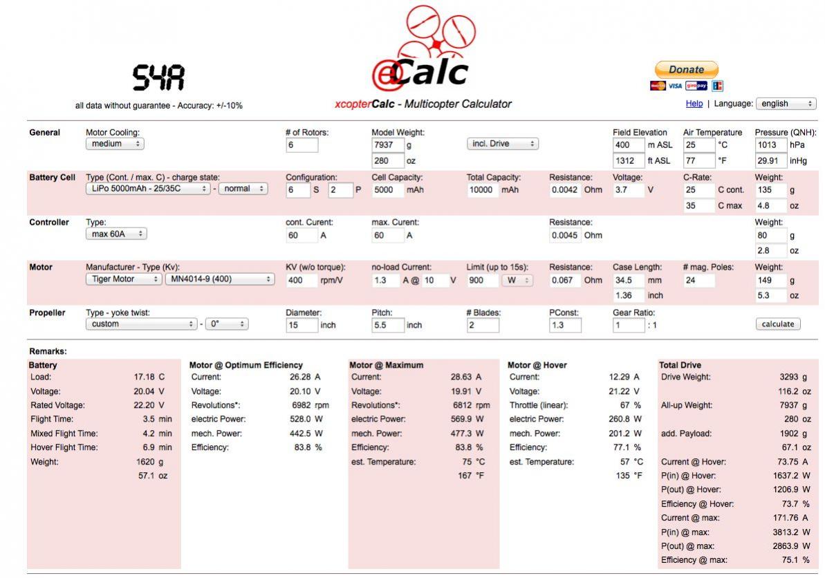

This is what I get in eCalc...

I have a Skyjib hex which is 1.5kg heavier than yours, ecalc gives me a hover time of 12 mins with my setup. (When I enter your props and motors on mine I get 9.7 mins)
I am getting 10 with the Zen 5D and 2X 8300 mAh lipos, 7 mins with 2 x 6200 Mah

tecee- some things to consider for flight times, your lighter then a s800evo w/ a gh3 setup. the 5d setup weighs a little more but with a 6s 10k mah you should be close to 10 minutes. what is your throttle percentage at hover at in manual mode? make sure you voltage settings are correct on A2. one 5400 batt is not enough for any decent flight time at this weight. if i run an ecalc i get close to the times your reporting on 1 5400 batt. the hover amp draw w/15x5 is being reported at 70 amps at hover- that is very high. keeping everything the same and switching to u5 motors lowers amp draw to 57.92 The results that people are reporting w/u5's are even better then ecalc reports and flight times are not 100 percent just a guide-keep in mind.. if your hover at throttle is around 70 percent then there is the problem, to get closer to 50% which is ideal you will need 16X5 props. Another thing is your esc's are too big and are costing you weight. you motors at max amps produce less then 30amps w/ 15x5 props. a 40 amp esc will be more then enough and will save you over 100grams compared to the 55g weight of maytech's -not a huge deal but something to consider. run 2 5400's on 16's then report back your hover and flight time and batt usage and i can calculate your amp draw then we can see if other motors will get you better flight times. i am in the process of building a 950 as well w/ a gh3. Same setup as you but u5 motors or kde motors and 40 amp esc's. changing to 16X5 prop with two 6s 5400's will get you in the 50%hover range and close to 9-10 minutes. you have to test of course cause e -calc is off flight times and just a guide.

quinton- judging by your numbers and flightime assuming you flying with 20% capacity left in a linear draw like a hover it looks like you using about 13amps per motor-if my math is right of course..lol if we look at the u5 chart specs w/ 16 props and on 6s and look what 13amps lifts per motor is it's 2120 grams of thrust. if your auw is 9437g then you only need around 1572 grams lift per motor. on the u5's you can lift 1750g per motor with an amp draw of 9.4 amps w 16's props. So your amp draw will be less then 9.4 per motor cause you don't need to lift 1750g per motor.. Even if you were lifting 1750g per motor it would be less then 13 amps per motor. This is why ecalc is off on u5 motors i don't think the thrust per gram was right in the software. A guy on a cinestar got 21 min on a 24lbs octo w/ u5's that includes the simulated weight of an epic with two 6s 10k's i checked his gpx file cause he's on mk and it was true. he nearly doubled what e-calc was predicting of 12min and his hover was over 62%. i'm trying to sort this all out for my build..
when we look at the kde 4012 motors the numbers are even better less then 7amps per motor roughly for 1645 grams of thrust. any way- the predicted flight time with u5's with 9amps draw per motor is 14minutes. keep in mind that your amp draw will be less so even better time. the t motor spec sheet doesnt show exactly what the amp draw will be at your exact weight per motor so this flight time is conservative i'm using closest heavier number. on the kde motors at 7 amps draw per motor would be 18 minutes, but really better cause i don't have exact spec for your exact weight so the numbers are assuming you weigh in at 9.8kg. the kde spec is with 15' props btw. the required thrust per gram for your weight was closer to exact amp draw on kde spec sheet on 15's so i went with the closet heavier number as well. now if these numbers work in real life gotta test i suppose but theses flight times are assuming your only using 80% of the battery so they should be close as long as my weight of your copter was right.
if i use 13.6 amps per motor then i get 10.4 min with your current setup. do you have 20% remaining batt life after flight or used about 13,280 mah in that 10 min on the dual 8300's ?
