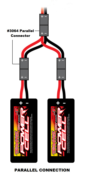

The batteries need to be the same number of cells and the same capacity - connected in parallel and of similar performance. red to red, black to black. Ideally identical batteries to ensure they work together evenly.
The copter will draw the current evenly from each pack. If they are different capacities, one pack will run out before the next.
2 x 3S 2200mA packs = 3S 4400mA packs. You don't get quite twice the running time because you add the weight of the extra pack. If you keep adding packs, it gets to the stage where you are only adding a pack to be able to carry another pack without any duration benefit!

Do you know where that adapter that is in the image you posted can be purchased?
darowden
XT-60. I found the harness on ebay, and also the EC3 to XT-60 adapter needed.
