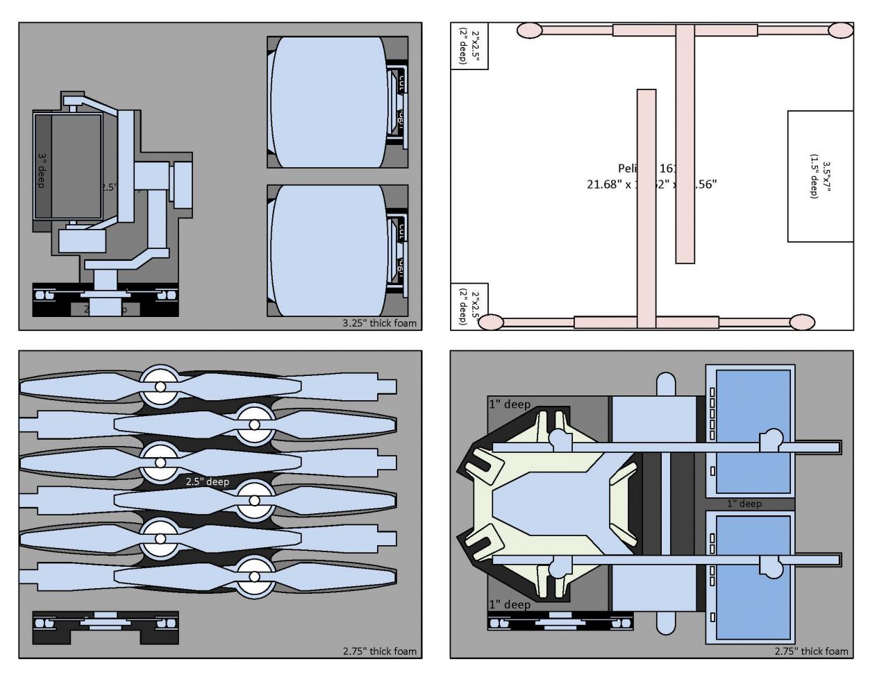

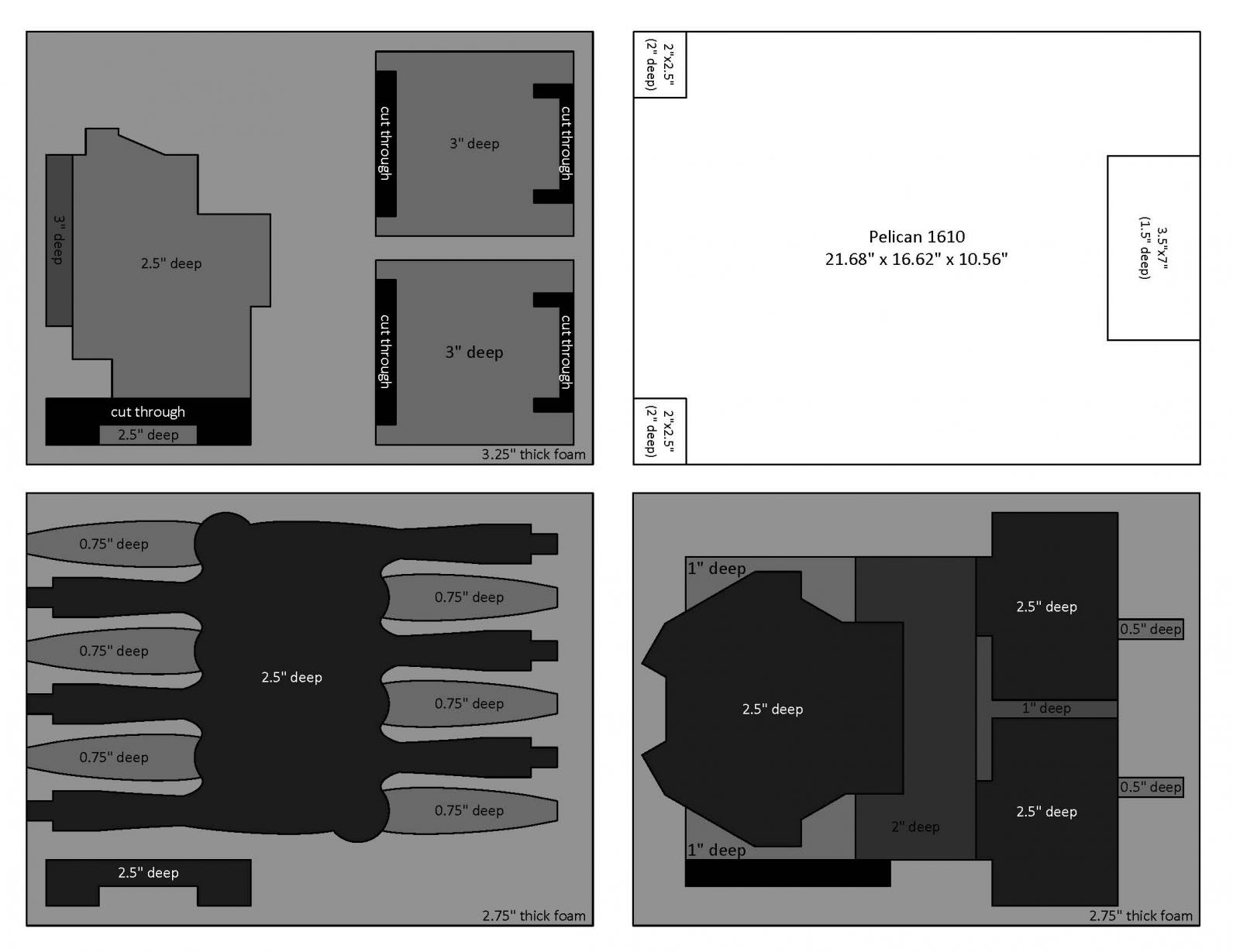

I went the same route as Louis did. My design puts the S800+Zen+Retracts, etc, in a 1610, but requires the legs to be removed as Louis shows, and requires sliding off the Zenmuse.
View attachment 16850View attachment 16851
Nice solution... Excellent drawings! I can use these as a template...I was looking for something cheaper than a Pelican, but maybe I should pay the money and have the quality... I don't suppose you have any photos? :)

Louis, I am actually still "building" my case. I drew these up, then I got super busy. But I have to have it ready in a couple weeks because I'm gonna be traveli with it. After I bought my pelican case is when I got my anti-vide kit; now it's gonna be a little tight height-wise. If I can, I might reconsider and go with a 1620 case. Oh, and if you want more than just jpg photo, let me know.
