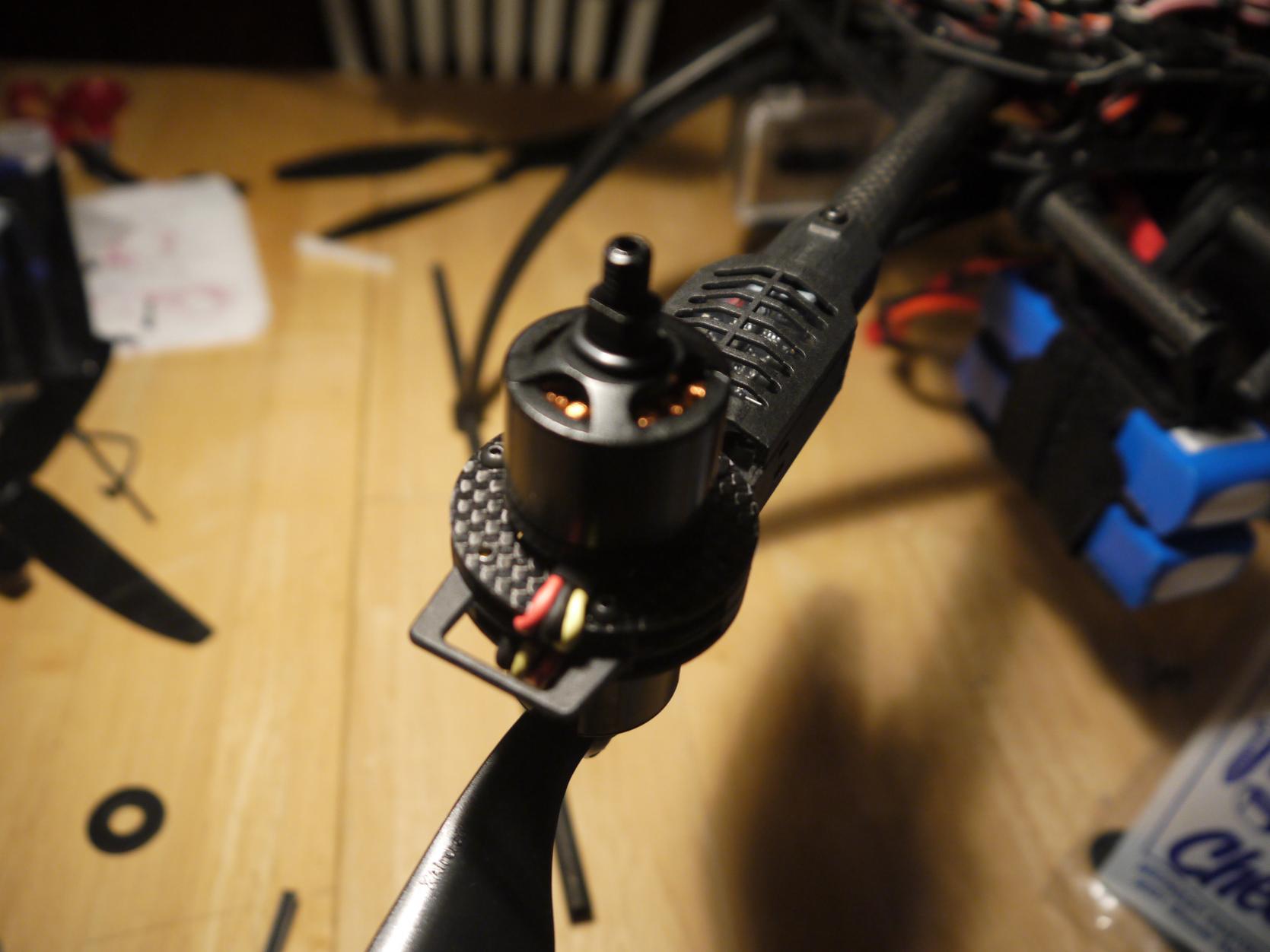

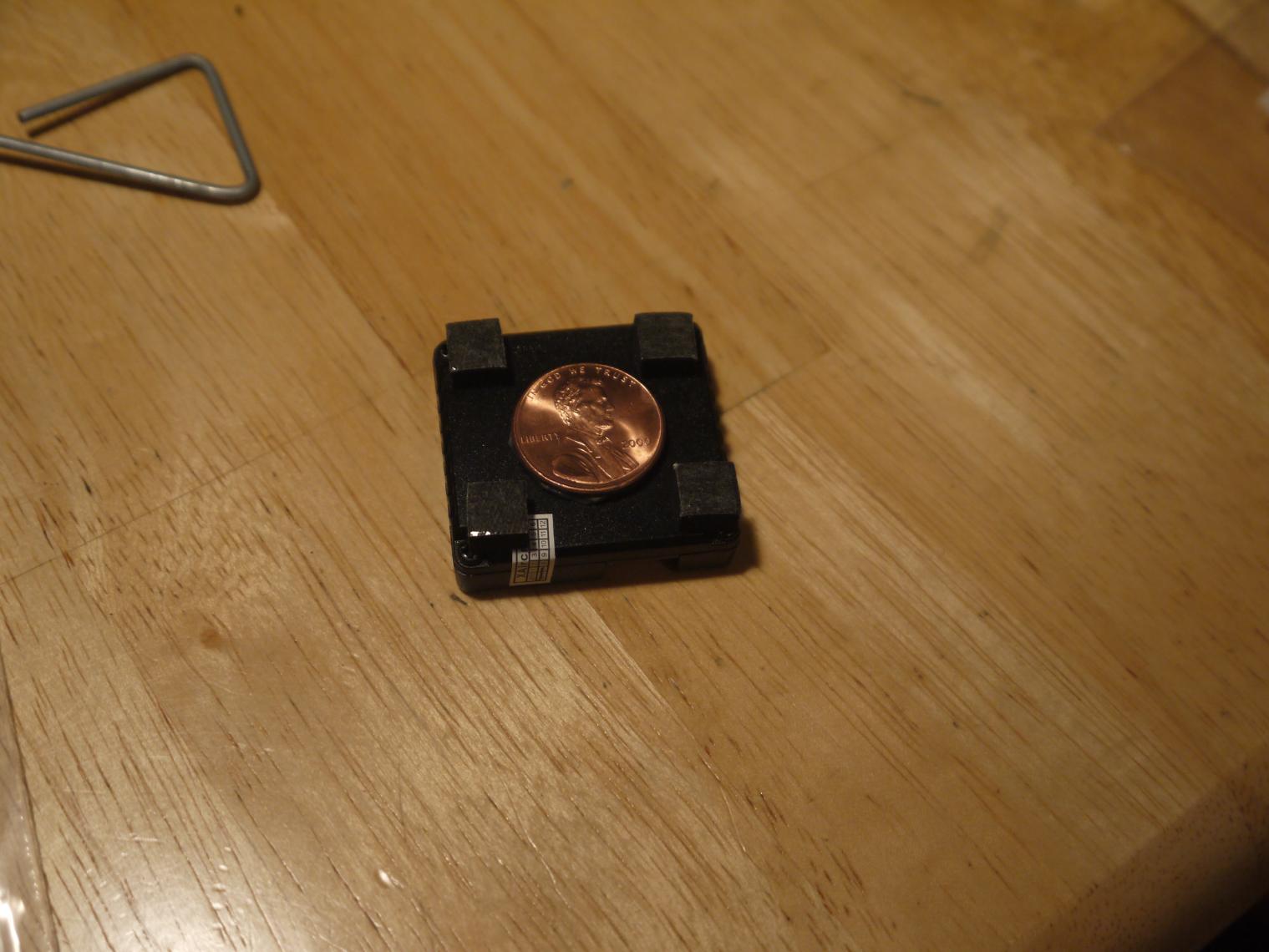

Progress has been made. I addressed a few of the things I was worried about with the 650 and it's looking pretty good. Of course, as soon as I finish we get rain, and then 10-15mph winds the following morning. I couldn't wait any longer though and took it out in the wind this morning. I am impressed so far. It will be nice to get it out in some decent weather with the FPV gear on to see how it really handles, but I like what I see already.
The biggest thing for me was replacing the props with some APC's. I was a little nervous about doing this, but after I experimented with some old props first it was no big deal. I used a unibit and opened up the the hub to 11/32 (8.71mm) and then took it down the last little bit with sand paper & a file. The hub of the prop was just a hair short so I added some rubber O-rings between the prop & the motor. It works great.
Lastly, I added a little weight to the bottom of the AHRS unit. Jeff mentioned this to me, so I figured I'd give it a try. I don't have much to compare it to as this was really the first real flight with everything set up. They are adding a small metal plate to the bottom of the new units to add more weight from what I was told.
