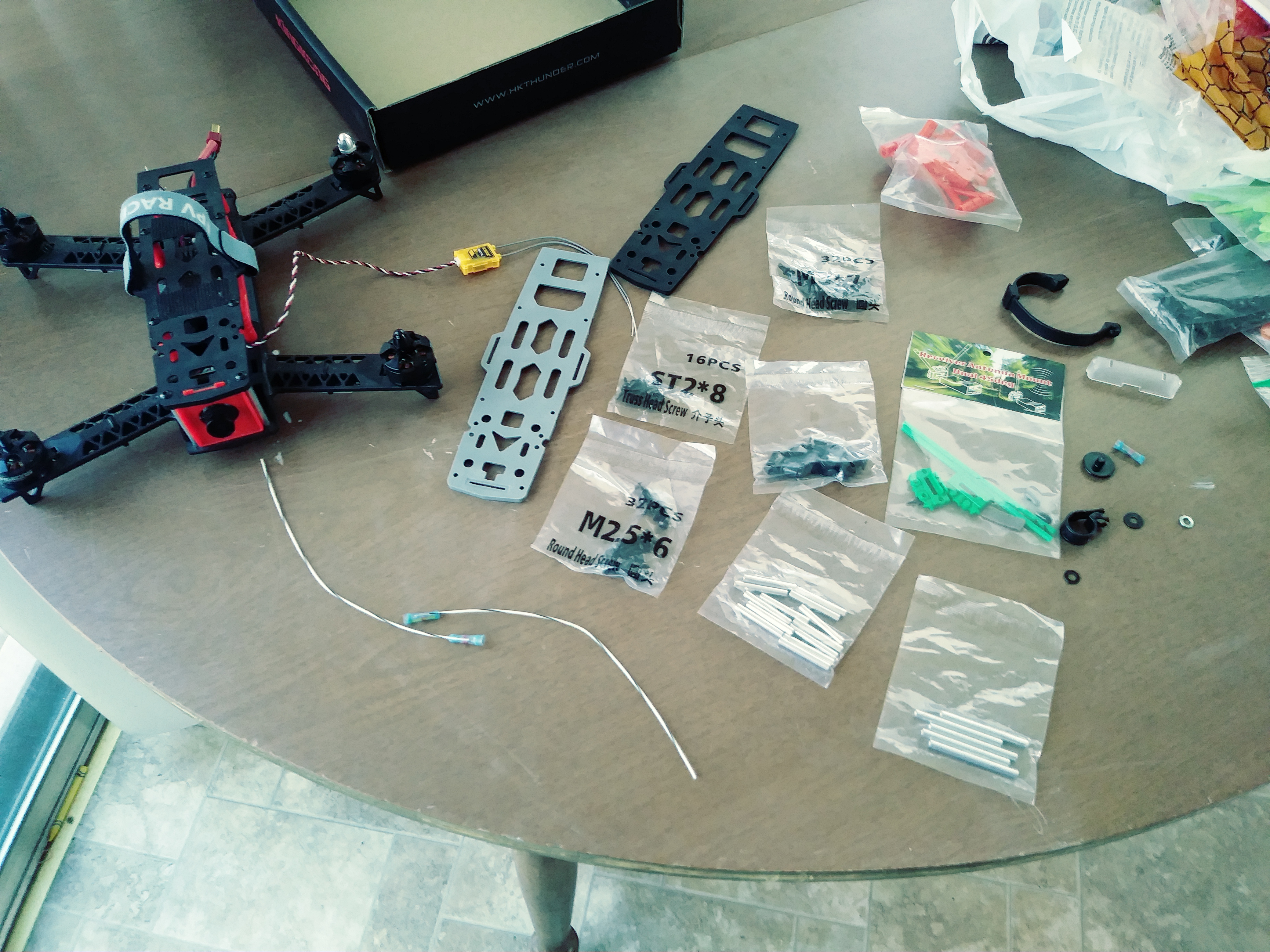

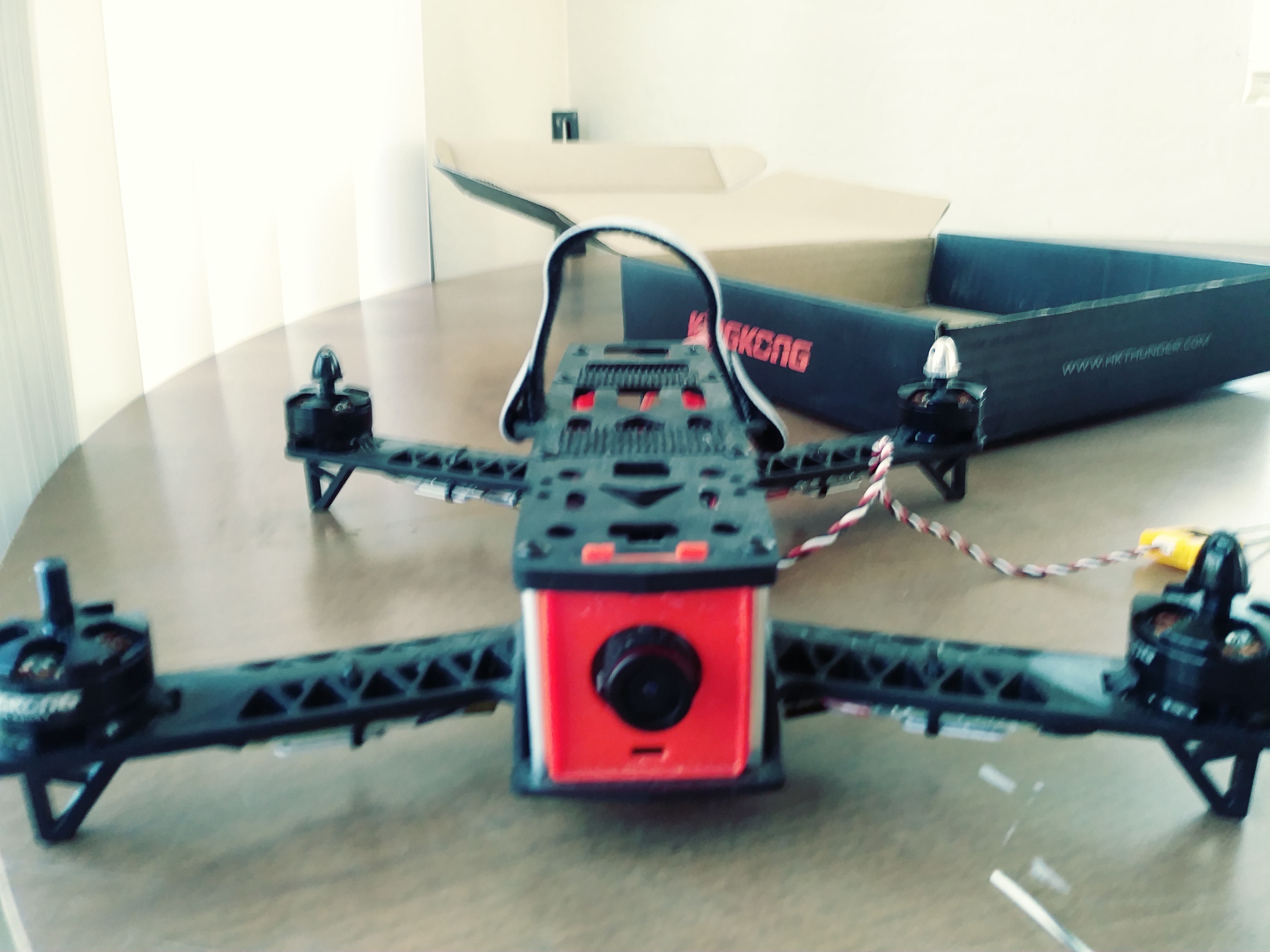

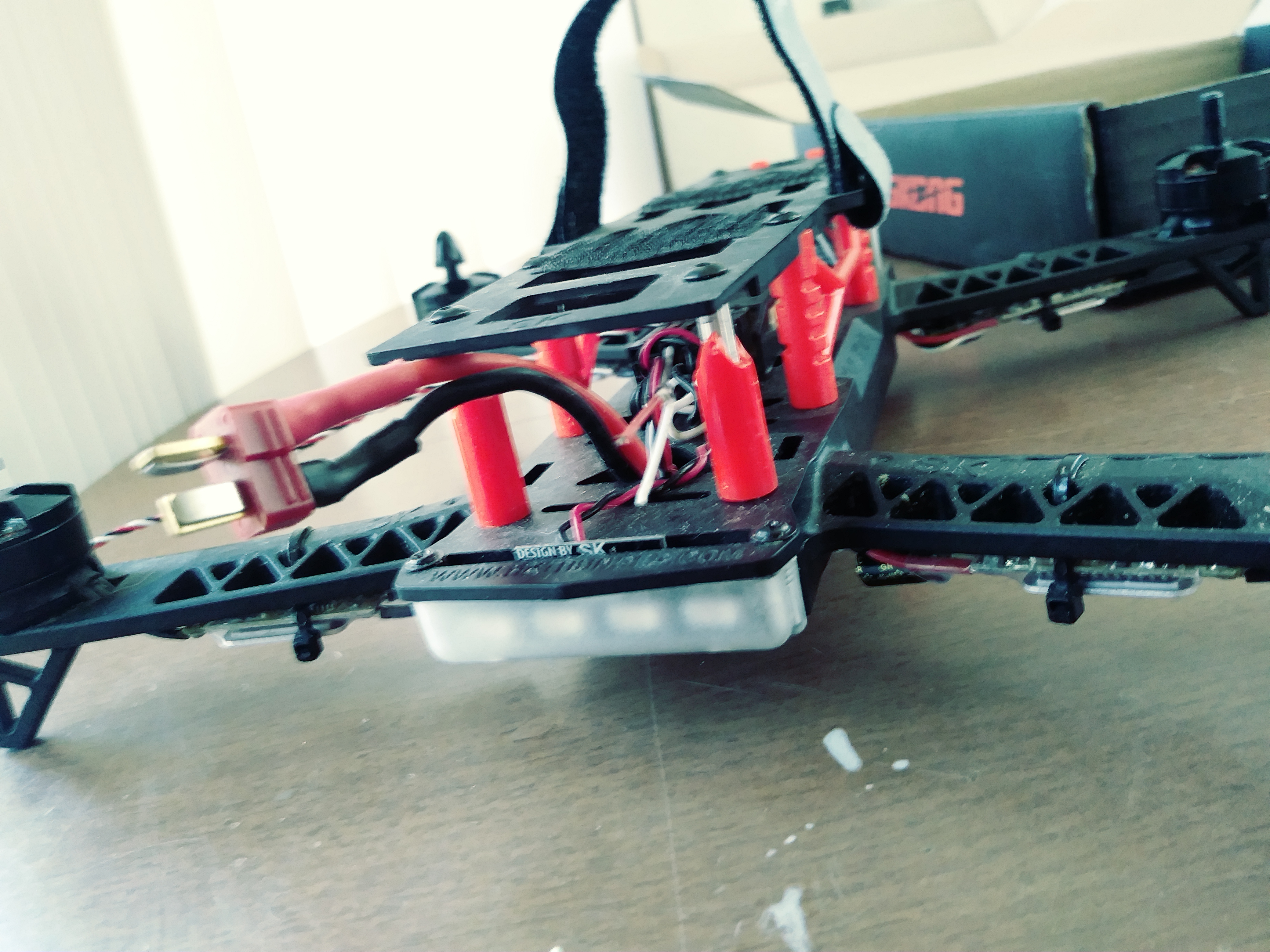

Hope I'm not in over my head. So i bought a Kingkong 260 today .It needs a lot of stuff I imagine. Remote control, battery, and I assume some wiring to be done. Where can I get a parts list for it? Any suggestions would be really appreciated. Keep in mind only paid $10 for it. I have pictures if needed.

looks you got only the frame and the motors and a reciever. so u need all the electronics esc flight controller etc to get it flying the combinations are endless so if you dont know what u need your better off taking it to a rc shop to get some help
Customj79
holybro tekkos allin one 36$ / 2306 2500kv 3bhobby motor 13$ a piecec cyclone 5043 should be able to fit 6040 might be a little much for those motors I use a flysky i6 transmitter controls bounce a little have tune it out but I would go with a frsky taranis x9d range from 100-280$ or a turnigy 9x should do 74$ every thing comes with instruction and you have to be able to solder taking it to a hobby shop would cost lots of money and takes all the fun out and if you crash you know how to build it good luck and happy flying
it would do some good to look on www.fpvknowitall.com
