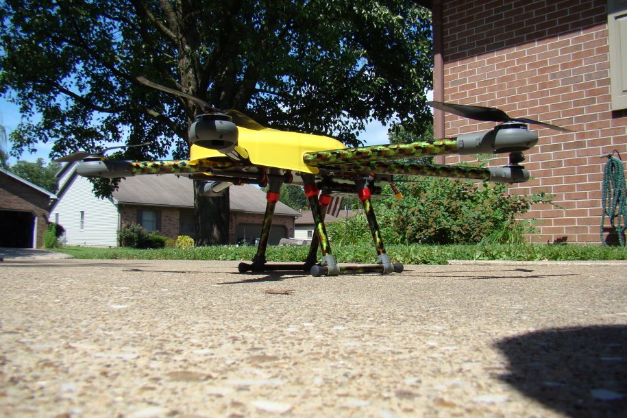

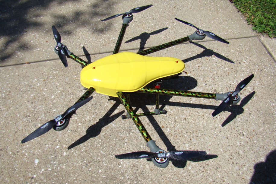

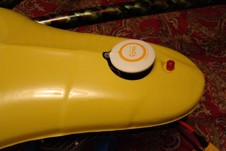

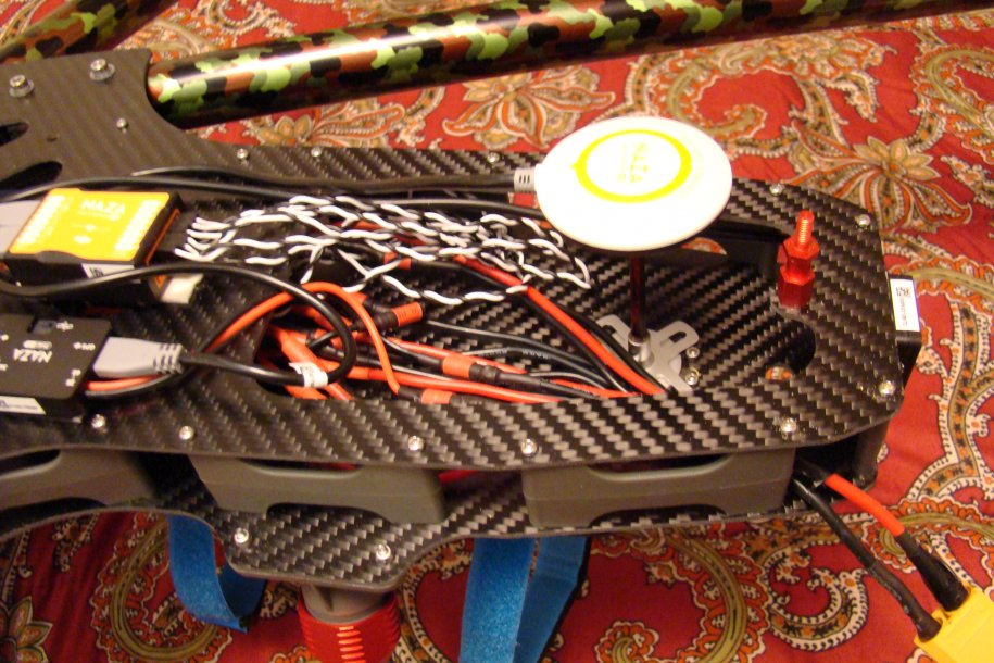

After building my Tarot Ironman 650 I decided to build a Hexacopter. I choose the HobbyLord Alfa-H6 1000mm. I was looking at the Sky Hero Spyder 6 but I believe the Alfa-H6 is the clone of the Sky Hero at half the price. Here are the specs. ST4708 motors, Hobbywing Platinum Pro 30amp ESC's, RC Timer 15X5.5 CF props, Naza-M V2 FC, and it is powered by a Multistar 6S 10C 10000mAh Lipo. Maiden flight went great with no problems. I still need to do some time studies to see just how long my flight time will be. A gimbal and camera will be added later.
