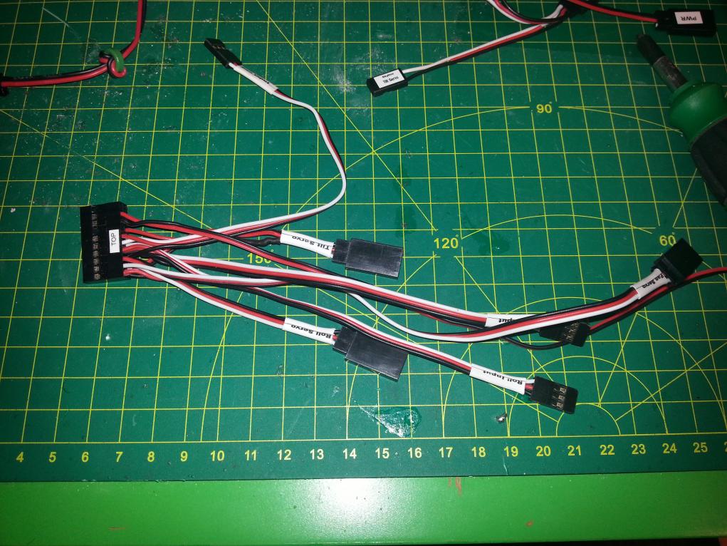

I have a cable harness that came with the skyline, please see picture:
This is the harness that came with the Skyline...

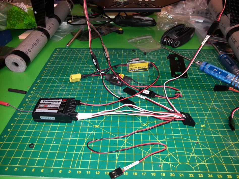

I have this setup:
Here i have the pan tilt and roll inputs in the reciver, the "roll pot" is not connected to anything, the roll servo is not connected to anything.
I use the harness and that have a input for power, here I use the 7,2V and on the same battery, I have a ubec with 5 volt that is used to power the Skyline. When I power up, the LED goes solid, and it just tilts to one side and just blinks red with 1 or 2 seconds...
From the skyline:
Roll Servo : Empty
Pan Servo: Pan Servo
Tilt Servo : To cable harness
Pan Servo : Reciver
Tilt Servo : Reciver
Roll servo : Reciver
Roll Pot : Empty
I need to run high voltage, cause it's slow when i use the 5 volts the ubec provides...
Anybody knows how to do this?
PS; This is the harness that is connected to the skyline :)

Hi,
Skyline is rate for 7.2V MAXIMUM. I fried mine while I was beta testing it by using a 2S LiPo (7.2v is 2S in my mind...)
If you want o run your servo with 7V and up you must power your servo apart from the skyline. just use the signal cable to the skyline and power your servo from a dedicated Ubec.
Link the ground from your ubec and from the skyline together.
Yeah, my setup as we can se on the picture is 2 ubec on the same battery, one with 5V to skyline, and the other with 7,2 to the servos, when I power up this the servo roll a bit to the right and then starts flashing red.. But I will try 1001 Copters tip, I will twist the ground wire together after the ubec and see if that works :)
