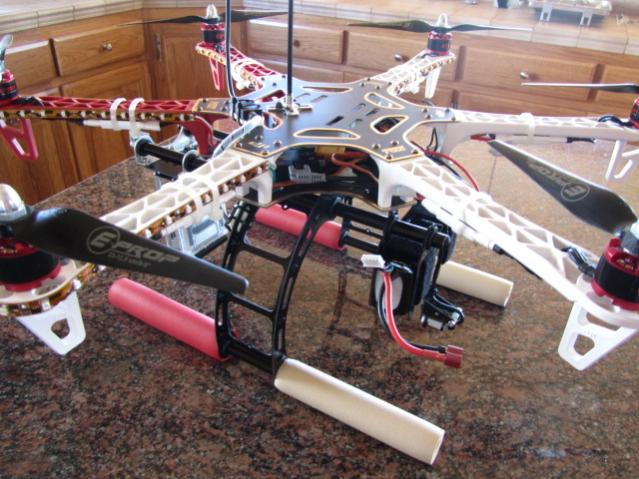

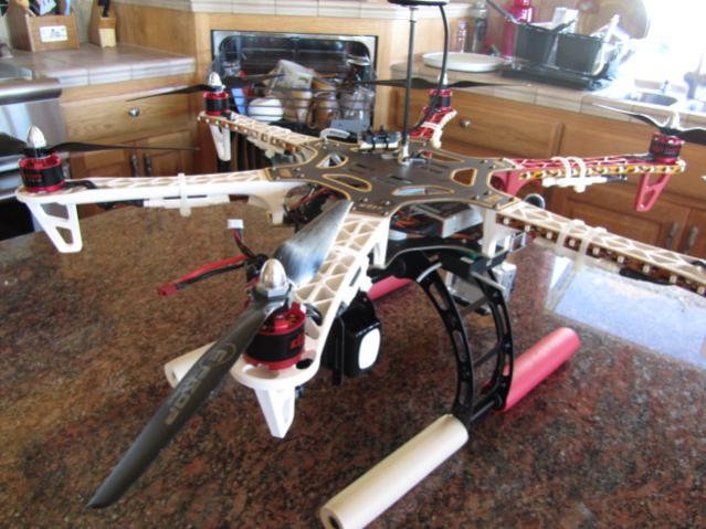

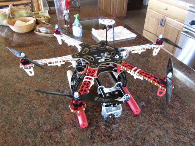

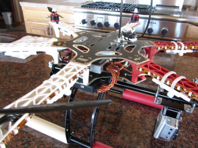

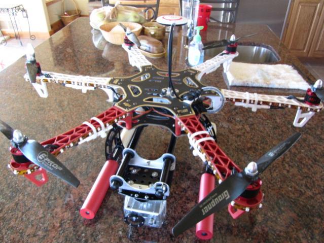

I do have landing gear and a camera mounted on it. It's the Aeroxcraft landing gear, so the battery and camera offset (or balance) each other. I'll post pics soon.
I did use the CG and not the center of the frame for my mounting dimension inputs.

Some pics of my set up.
Jim
