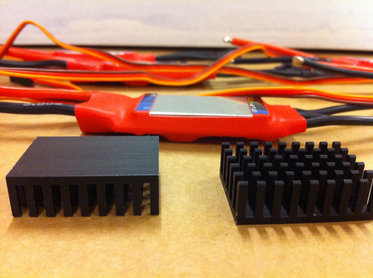

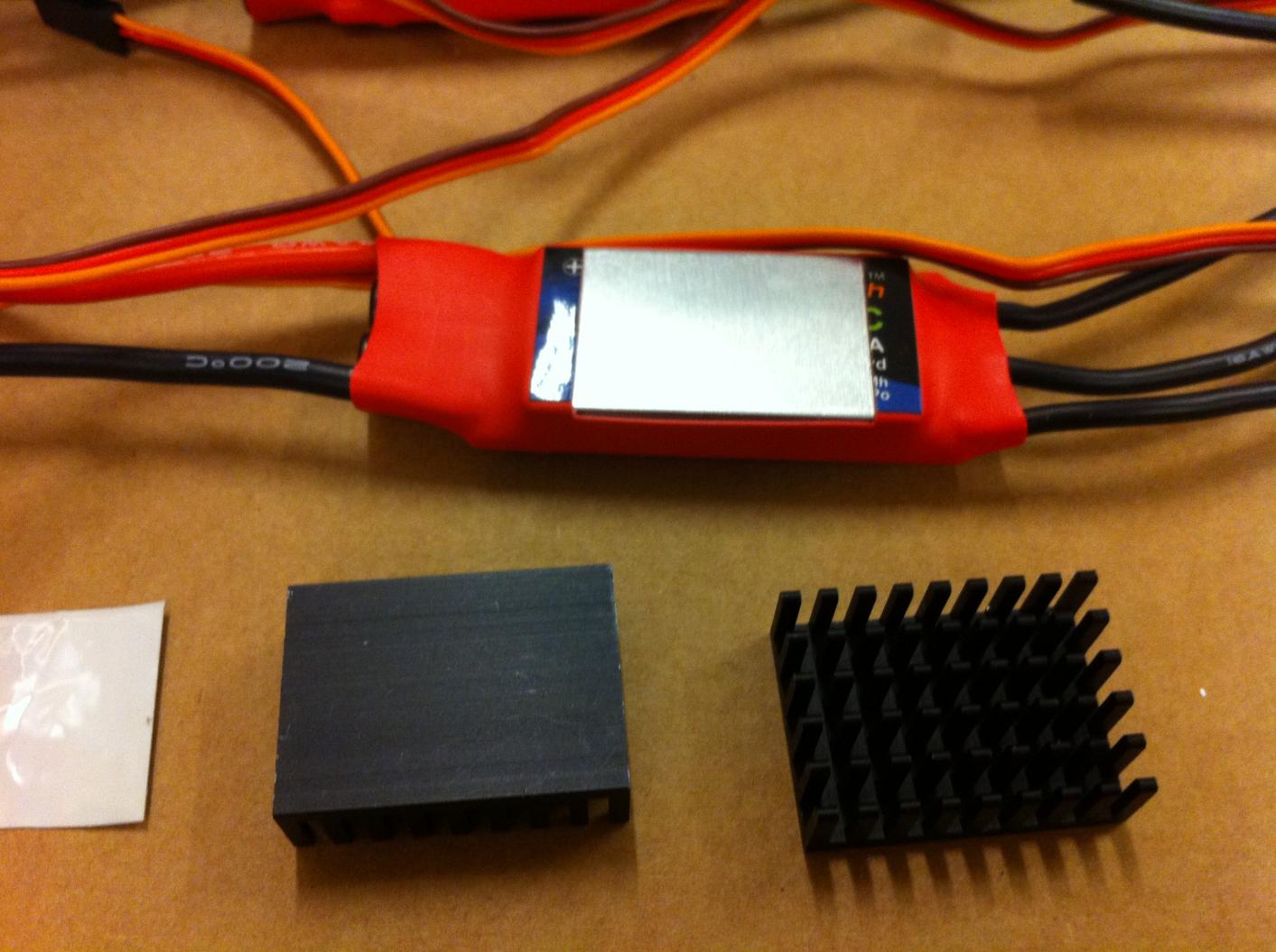

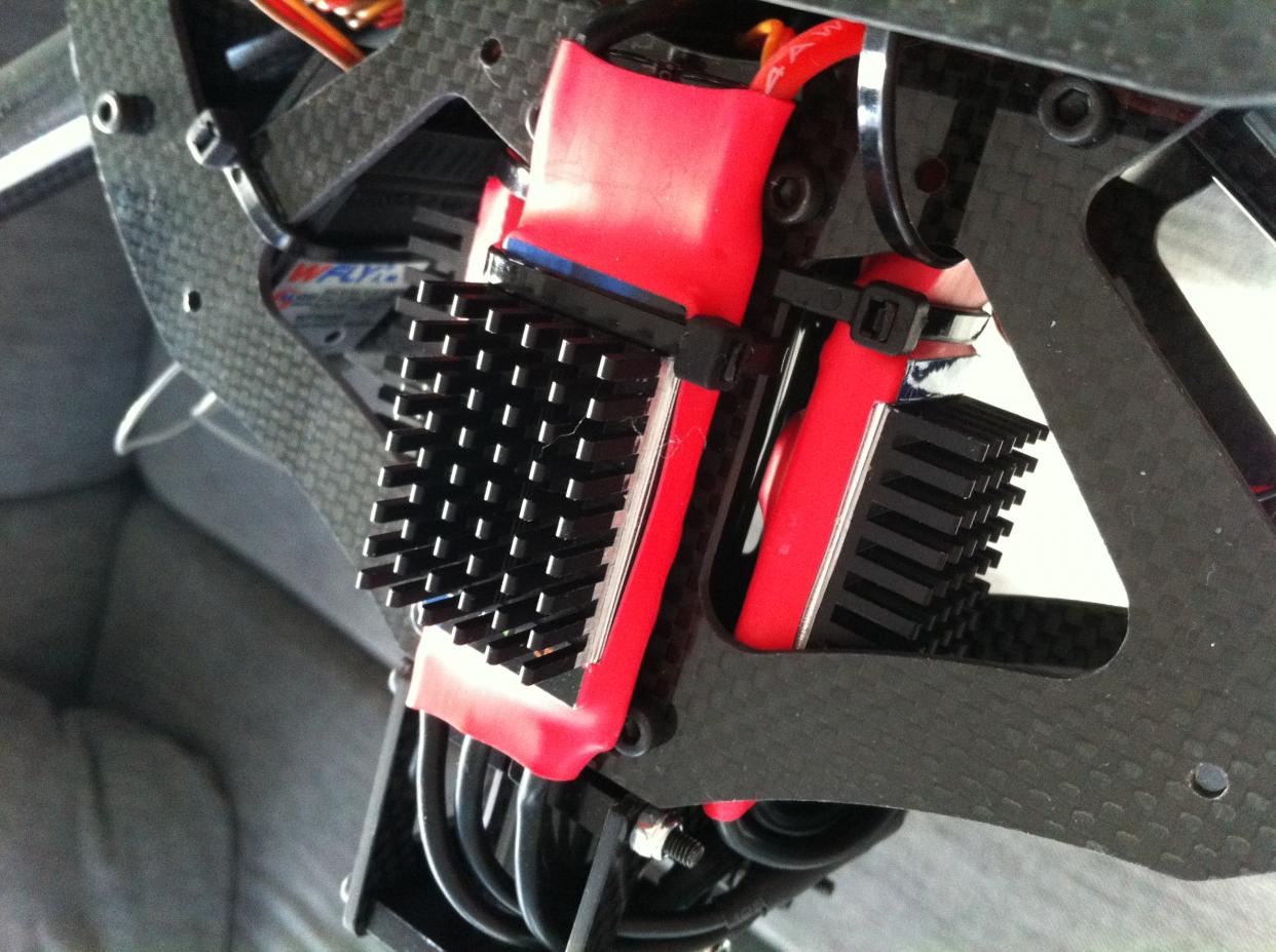

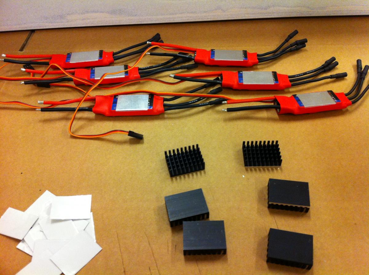

Sebas600
www.farnell.com www.rs-components.com
these were from farnell. 40x40 and made them a bit smaller to precise fit the esc, took of two rows of ribs.
make sure not to cut of all the heatshirink so the smal plate comes lose, leave some on the sides where the wires are. 3-5mm each side
have used heat conducting tape. applied it to the esc AND the heatsink, rub it on well with the back of a screw driver or something round and smooth.
and then put them together, this makes the best bond so de don not come off!!
