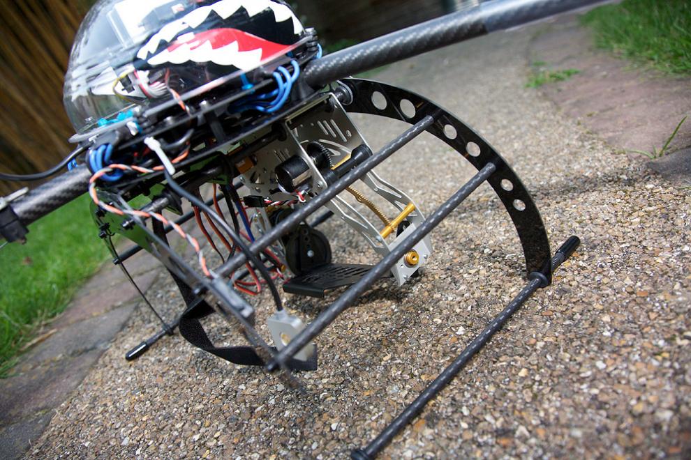

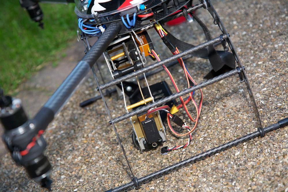

Damage.
Snapped one droidworx std landing gear plate

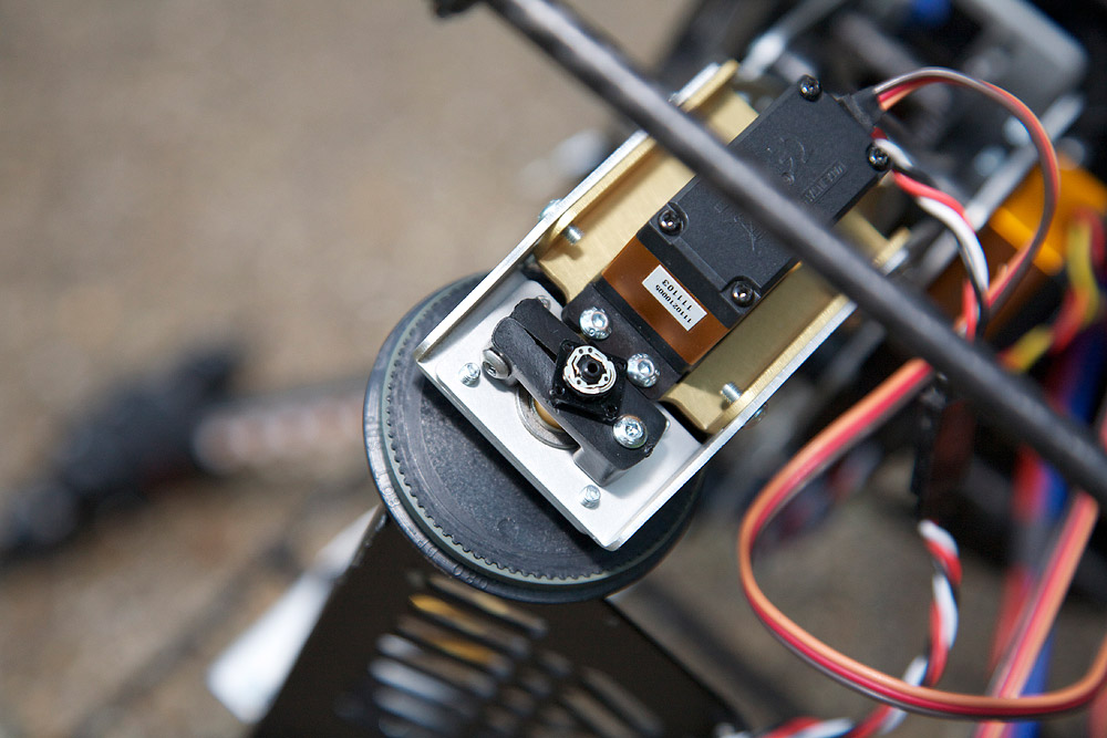

Massively bent and twisted AV130 roll cage, it's main toothed gear ring and camera plate
Broken AV130 tilt pot

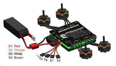

The alternative is to get one of theseView attachment 5417 or disable the low battery cut-off on the ESC .You can then disable the battery monitor in the DJI and work with a telemetry signal to your Tx. If you loose the odd battery it is still a cheaper and safer option.http://www.youtube.com/watch?v=dLBNBEzvvUc&feature=player_embedded
Simply disabling the DJI will turn the shutdown over to the ESC which will still drop you out of the sky because they will give you some warning wobbles first and send you off usually in a bad sideways direction.

Gallery of shame…
View attachment 5418View attachment 5419View attachment 5420
