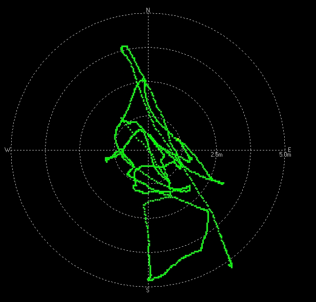

The GPS in consumer products is not that accurate. What accuracy do you expect? Feet? Meters?
Reality is that it will be accurate to 15 feet either way most of the time. Below is an MK when sitting on a table.
Maybe there's something else going on, but the first thing to check would be what the GPS is telling the bird to do.
Thanks for the input. There is a definite change toward the end of the flight. Like the battery power is maybe not enough for the GPS / Nav board to do the calculations quick enough... I will analyse the flight log and see how many satellites it has lock on when it starts.. Ill also try and film it.
