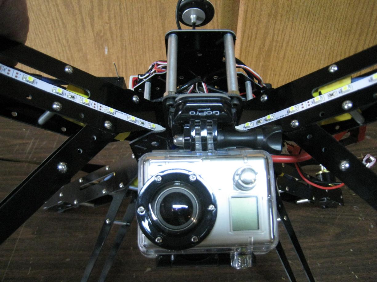

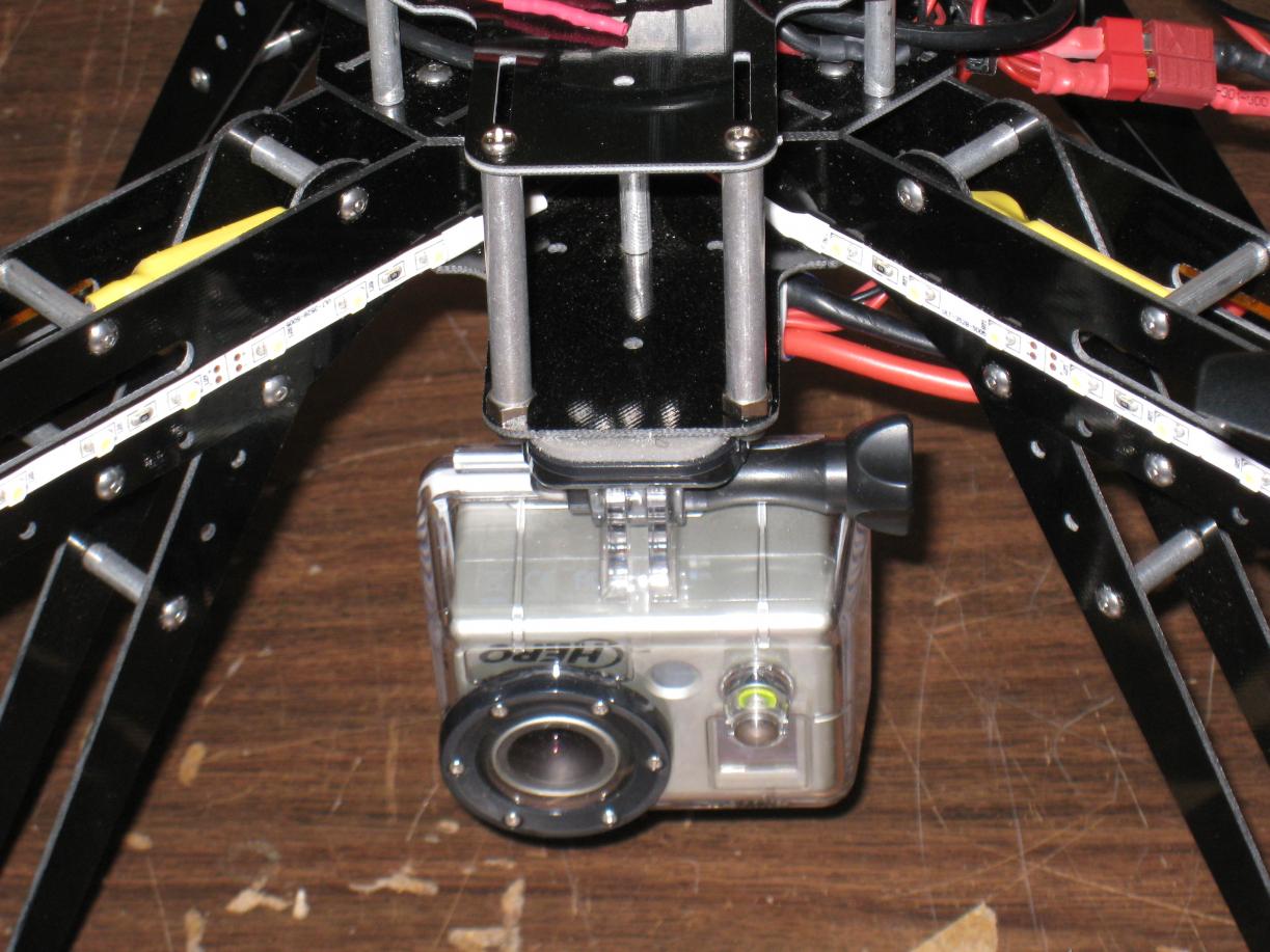

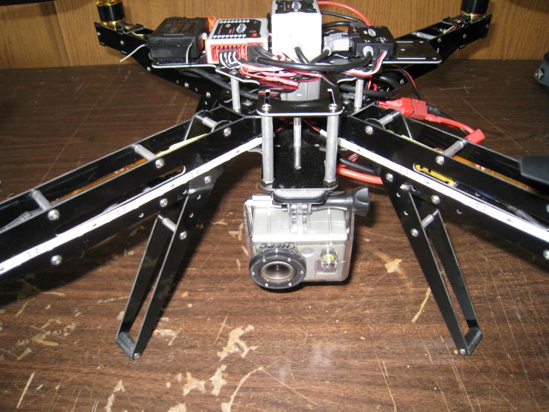

Here are some pics of my setup and a you tube showing the jello effect. I have balanced my props. I wonder if my frame is not ridgid enough or if I have a motor shaft out of balance, no crashes to damage a shaft. I'm running good quality Scorpion motors.
View attachment 1391View attachment 1390

That gopro mount might be the problem. Try and move the camera and see if there's any play between the camera and mount. On all of my mounts, there is a bit of play. Try either a tripod mount with a screw from the top, or to start with, wedge a bit of cardboard between the camera mount and the other side, which is stuck to the frame. Ie hold the cardboard between the mounts as you are clicking them together.

I have absolutely no play in the mount. It is rock solid. I'm wondering where the the camera is picking up the vibration. It did the same thing with the cheapo motors before I got the scorpions so I don't think it is the motors. My blades are balanced. I'm just wondering if I have to much flex in the arms of the quad. If I grip the motors I can tweek the arms a bit when I rock left and right. I wonder if there is a camera that would handle it better than the GoPro. Maybe I need to buy a new Carbon Fiber frame from somewhere.

I would try to add some mass to the camera base plate in the first instance. You can get quite good results with the camera mounted solidly to the frame and that should get rid of those artifacts. You will of course not be able to correct the models pitch and roll accept though post stabilisation which can remove some of that. Do you want to have fun or produce top quality production work. If it's fun then mount it solidly to the frame. Some airframes do have a natural frequency oscillation that is always there.
