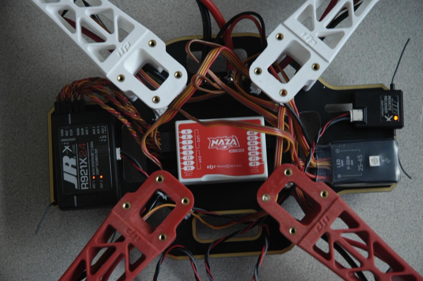

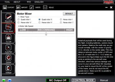

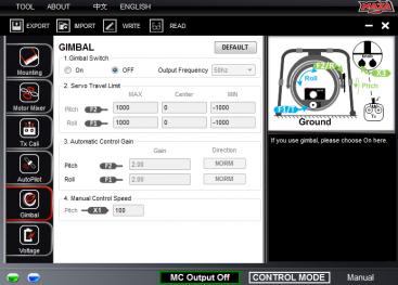

Hi all,

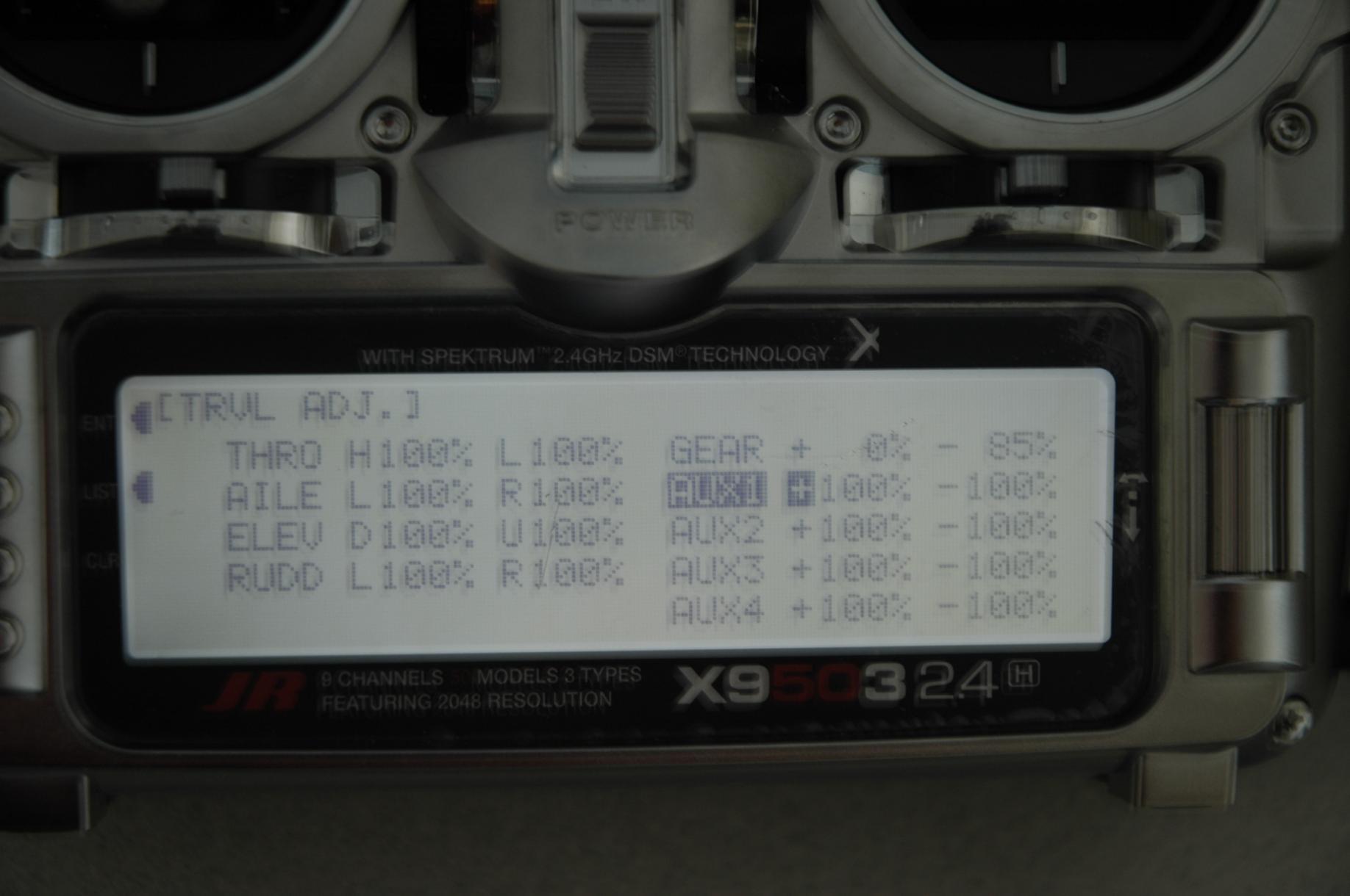

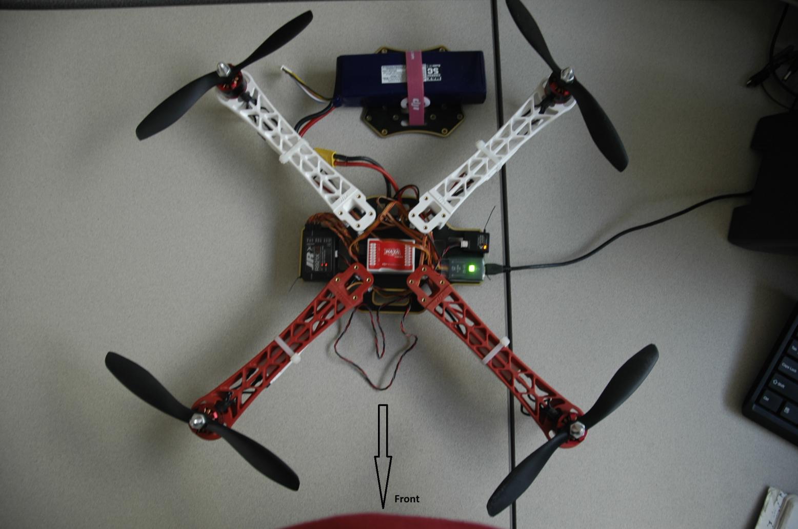

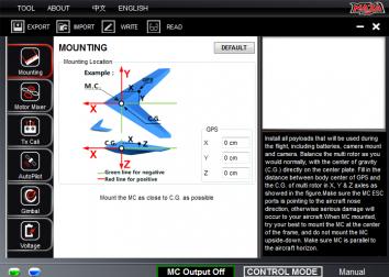

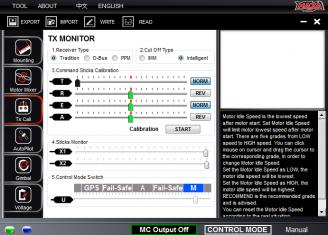

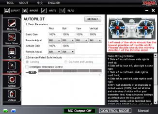

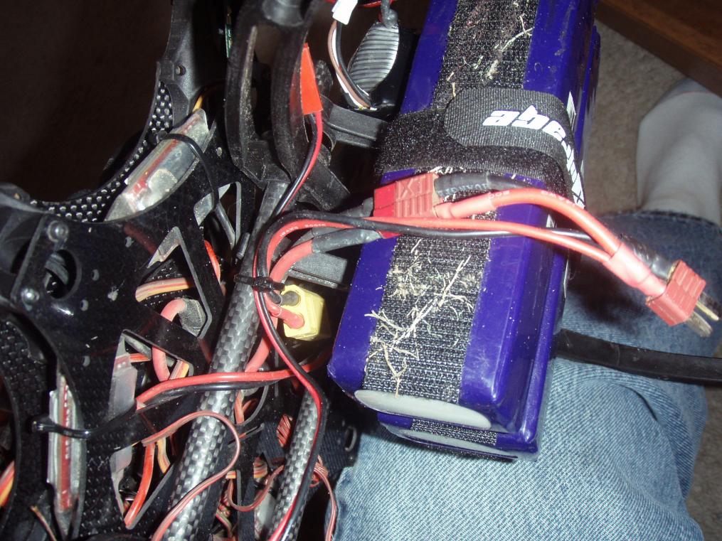

New guy to helicopter. Bought a DJI F450 a couple weeks ago with Naza M. I have a JR X9503 2.4 transmitter, a JR 921X2.4 receiver (including a remote receiver), no GPS, no Gimbal. The attached images show the frame and the setup with Naza Assistant 1.8. All the wires connections are correct and the motors rotate with right directions. However, it was very unstable, like dancing, even turned over, when I tried to fly it.
One thing to mention, on the transmitter, I did not change the default setting of the new ACRO mode I were using, except the Gear parameters, as shown in the last image, to satisfy the requirement of "Control Mode Switch" in the fifth image.
Something wrong, but I could not figure out. Any ideas?
Thx,
James
