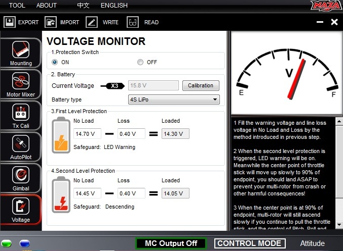

My voltage protection settings are as follows: (these are fairly new Hyperion 4S batteries c/w battery calibration via NAZA and multimeter).
