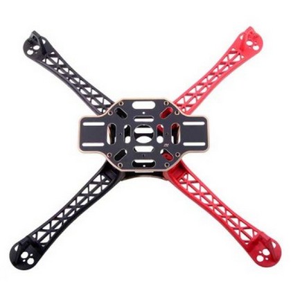

HJ450 Quadrocopter Frame Kit
Support KK MK MWC by new disign PCB board(Not Included) Recommend FF or KK
4 sets* A2208 or A2212 800KV~1100kv brushless motor. Recommend F4006 motor.
4 sets* ESC 15~25A. Recommend 20A
1* 1800MAH~3600mAh 3S LiPo battery. Recommend 11.1v 220MA 20C
4 sets* Sets 1045 or 8045 forward & reverse propeller. Recommend 11*47 Blade
5CH or 6CH Transmitter. Recommend DX6I
Hope it can help you.
