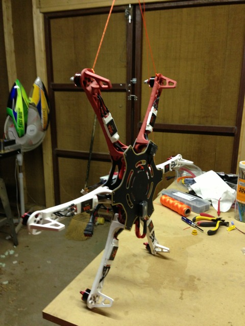

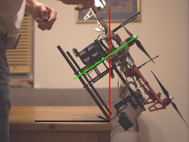

So you needed to find the Center of Gravity.. Ok guess I didn't understand that part.. I did it with string. Hung the 550 by opposite arms so I had free hands to move stuff around to where I felt comfy. Then... I had a screw in a board or some type of point (saw a guy do it with a wine cork) and set the 550 on the point and found the precise balance point. That is your X,Y CG. For your Z CG you can balance it on your front arms and work the angles like in this picture. I personally also used string Hung by two rear arms. It's about 1/4 or 1/2 in above my table. But not touching that will throw off the angle. then gravity will hold the right angle and you have free hands. (I do this on my helis by the main shaft also). But I crash my 550 and broke and arm. So I turned it into a quad. And never changed the CG in the Naza. It still is very stable.
