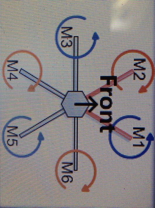

There should be a dji stamp on the top. And there will be a slight curve on them almost like it higs the air underneath
hjls3
Other way around. Arm #1 ccw. Here is a pic for you. Before putting the props on, I would fire it up and make sure the motors are spinning the right direction. If they are not, just switch two wires between ESC and motors. Doesnt matter which two. Then put the props on and go have fun.
