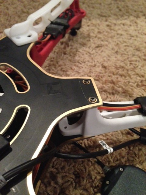

As I crack open a cold one..I sit looking at my F550 and propellers scattered everywhere. Props Broke, GPS mount broke, frame cracked

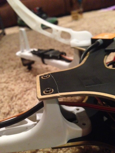

I have an AP gig NEXT week, I noticed one arm section to my f550 PDB frame has cracked. It's not all the way broken off, but obviously cracked. Can I reinforce this and still fly??? It'll turn on with no props, but I have to order a few more this week. Worried about putting it back in the air

Just buy a f550 frame and replace the broken pieces. The Naza and the motors should be fine. Don't fret, this is an easy fix. As far as the fail safe goes, well there are a lot of variables, your home position could have been set in the air if you were impatient, check the software to see if the fail safe is enabled or when fail safe goes into affect. Would have had to been there to see what the true cause was

Thanks man! Feel a bit better. What's odd is my home position was recorded before takeoff (multiple green LED's). Almost as SOON as my controller says "low battery" on the tx BOOM it went down. I'm going to order a new PDB next week. But due to shipping times I won't have it for my gig Monday. Does anyone think this cracked piece is able to fly after reinforcement?
