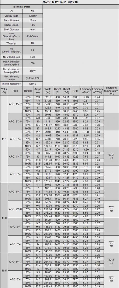

Ok... Heading into Dangerous territory here... Actually trying to figure out Ecalc. Would any experts out here be kind enough to take a peek and help me determine if I'm inputting correct information and highlight areas of concern?? Genuinely appreciate any help.
Backstory, AD6 - Converted to X8, T Motor 2814-10s, 12x4.5" Carbons, AV200, 2-6000mah 4s and T3I/24mm Cam sinks in Manual - Leading me to believe I'm too heavy and/or under-propped.
View attachment 12184View attachment 12185
Your gram per xxxx. Way too high. Even a 12,000mAh 6S doesn't exceed 280g. You've got 580.
clue is the battery weight, bottom left. 4.7kg! For 2 x 6000 4s it should be well under 2kg.
