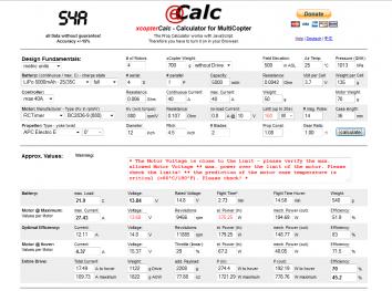

The max power rated for these motors on ecalc is only 160w yet according to the manufacturer it is 243w. So there is problem No.1 Problem No.2 is battery choice, I have searched previous threads and I see 4s batteries being preferred over 3s, especially for lifting a payload. At the moment I am not worried about a payload, need to get a handle of flying it first. However when using a 4s battery in ecalc the input power to the motor is way to high? Should I use 3s batteries and when I eventually/hopefully start adding a payload run 2 in parallel? I have also taken the time in copying other people's Setups in ecalc that are using 4s batteries with a similar setup as to what I am trying to achieve, yet I get the same result of the input power being too high for the motors being used.

You can't really play "what if" on batteries, motors, etc. unless you choose the "without Drive" option for the "xCopter Weight" and enter the figure for only your frame, landing gear, etc., i.e. exclude the motors, ESCs, batteries. Is that the way you're doing it? If not, that could be skewing your numbers. Perhaps post a screen grab so I can duplicate your setup and hopefully advise?

*EDIT* Sorry messed up the screenshots
Hi Jeremey
Thanks for the reply, I have already learnt a lot of valuable information from your previous posts on these forums. To answer your question I have tried both ways and when I do put in the AUW including drive I am a bit conservative and add a little extra weight as I have a good idea of what the frame will weigh.
Here are the screenshots of ecalc including drive and excluding drive using the same specs as above:
And here is a screenshot using 3s LiPos:

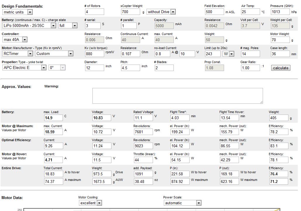

It does appear that the eCalc rating for that motor is wrong - the RCTimer site states 243W, so we'll assume that figure is correct. You can fudge this in eCalc by first select the motor from the list, then changing to "Custom" and entering the higher figure for "Limit(up to 20s). Remeber too to set Motor Cooling to "excellent".
What eCalc then shows is the motor is happy with 3S but only likes 4S with much smaller props (which makes sense - higher voltage generally requires smaller props or lower Kv). So definitely 3S 5000mAh 20 or 25C is the best choice. Btw - if can find 20C rather than 25C it saves a little weight.
Interestingly, Google pointed me back to this thread: http://www.multirotorforums.com/sho...C-2836-9-motors-and-different-prop-experience - which seems to confirm the same: @ovdt experienced very hot motors with 11" and 12" props.
With 3S you're in good shape - you could add a light camera and/or FPV gear (say an extra 700g) and still be hovering at 65% throttle.
