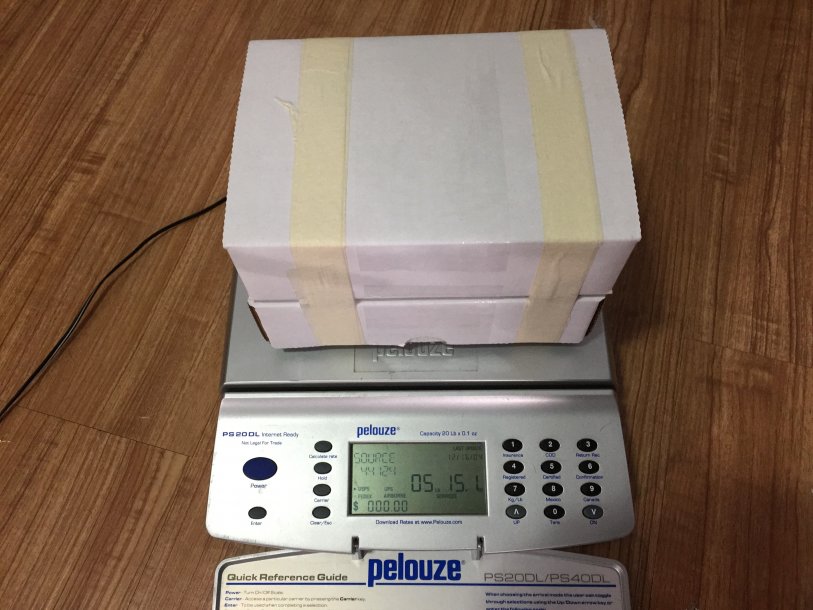

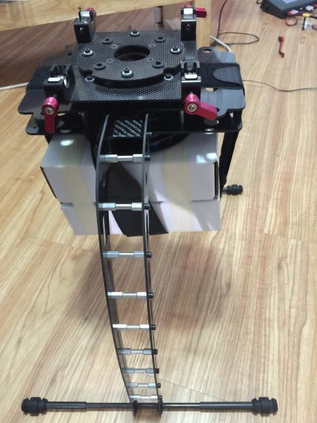

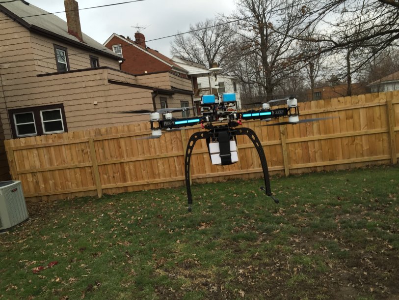

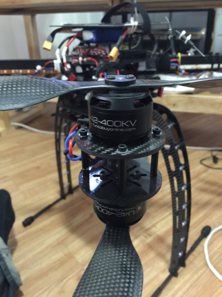

To start off I slapped the U42's on the rig. I then attached a 5.15lb package to the rig to simulate a camera and gimbal. (no need to risk my real stuff for a test!)
View attachment 21919 View attachment 21921 View attachment 21922 View attachment 21923
The air temperature was 31 deg F.
The Rig weighed 19.3lbs (8.75kg)

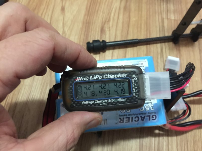

The resting ESC/Motor/Batts temp right before I took the rig outside for the test was 52 Deg F. +/- 3 deg.
The batteries used were two 5300 mah 6S packs that were charged to 100%

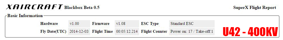

View attachment 21925 View attachment 21926
I then flew for 5:12 minutes. (see image) Just hovering at about 10 feet. I used Atti mode and just hovered and landed.

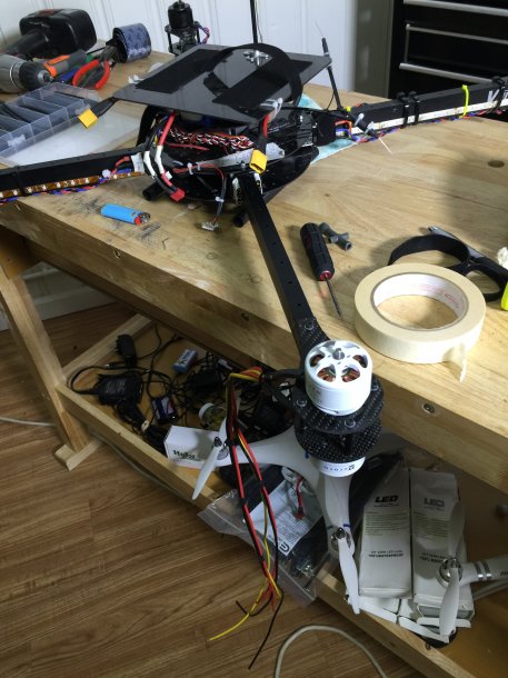

I then spent the entire night swapping motors to the Avrotos.
And after some work...(at 2:30am) the Avrotos were ready to go!

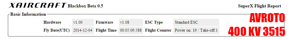

And so today I did the same test with the Avrotos as I did with the U42's...
The air temperature today was 32 deg F.
The Rig weighed 19.75lbs (8.95kg) ( slightly heavier due to the thicker motor wires)
The resting ESC/Motor/Batts temp right before I took the rig outside for the test was 53 Deg F. +/- 3 deg.
The batteries used were two 5300 mHa 6S packs that were charged to 100%
I then flew for 5:09 minutes. (see image) Just hovering at about 10 feet. I used Atti mode and just hovered and landed.

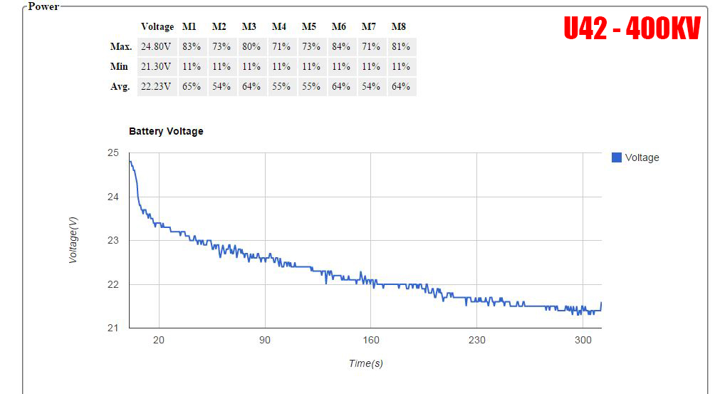

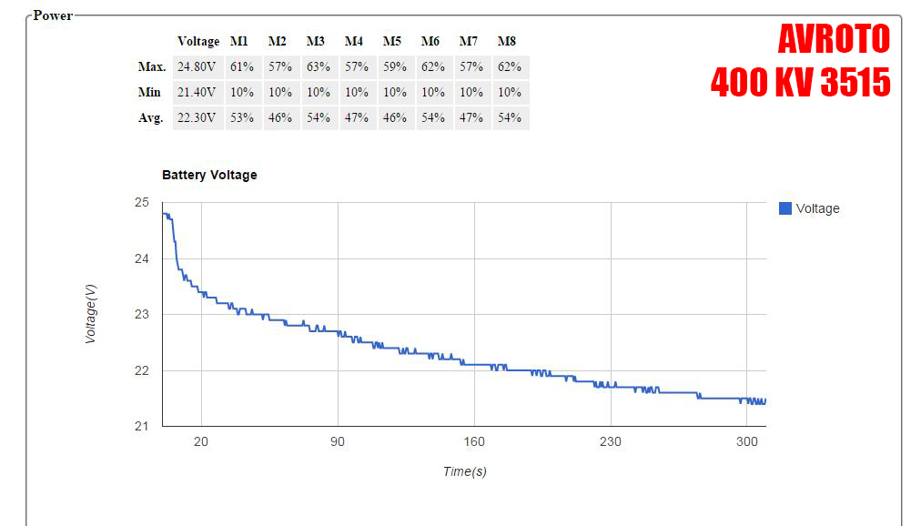

Lets look at the Power Output of all the motors:
View attachment 21931 View attachment 21932
The Avrotos had a pretty apparent power advantage using less total power on average to hover the rig. Also they seriously felt smoother. The rig did was more stable during the ATTI hover with less drift.

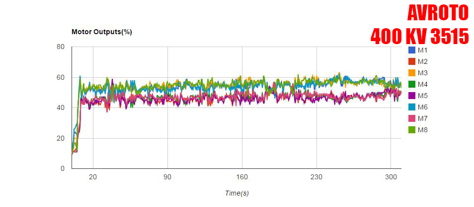

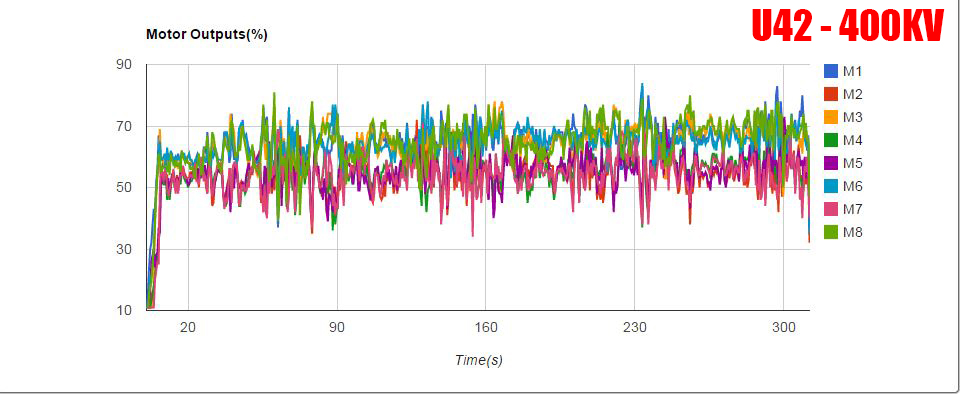

Next we will look at the output of the motors as a graph to see how "Smooth" they were... (probably contributed to the drift I experienced in ATTI with the Y42's.
View attachment 21933 View attachment 21934
Again the Avrotos trumped the U42's with consistency. You can see that the 4 motors in the "dirty air" had to work a bit harder, but both groups of "4" on the Avroto graph show a much more consistent power output.

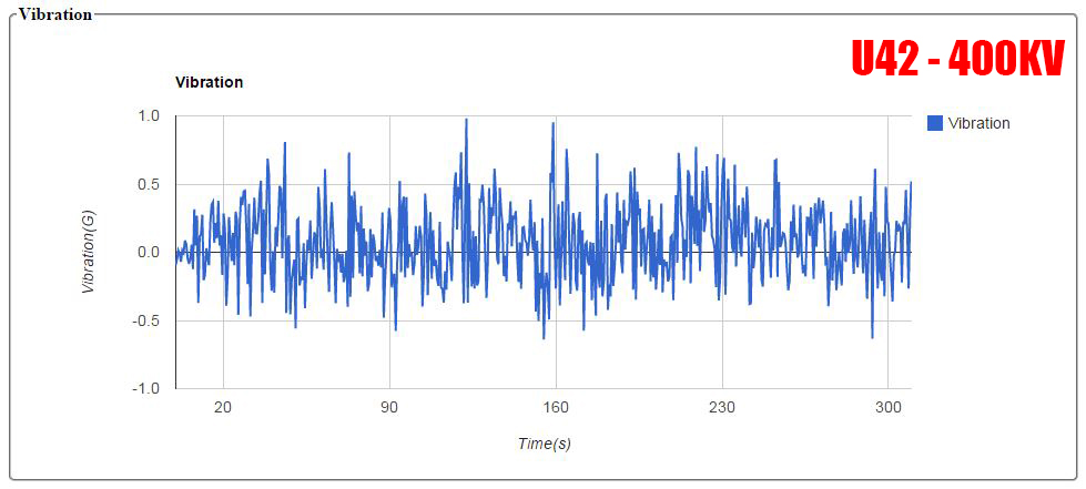

Next Vibration! One of the most important aspects when doing aerial video is vibrations, and here again the Avrotos trumped the U42's with a more consistent range. (also note I was using cheap, quickly balanced props in case there was an issue, I did not want to kill my good props!)
View attachment 21935 View attachment 21936

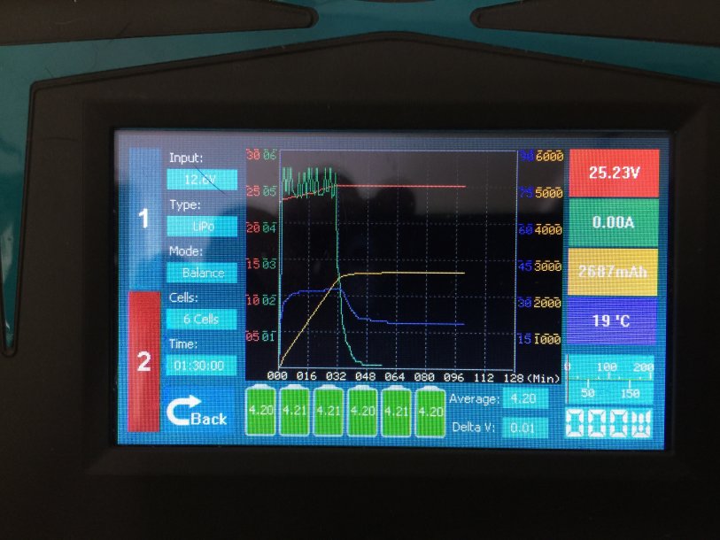

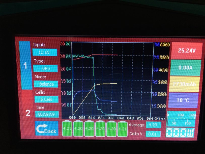

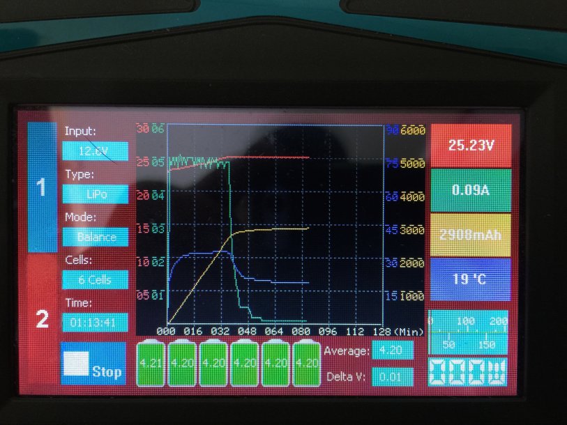

And finally, Let's take a look at some charger screen shots to see if there was any mah differences in the motors...
U42's
View attachment 21937 View attachment 21938
The U42's used:
Batt 1: 2687
Batt 2: 2908
Total: 5595 for 5 min of flight time.

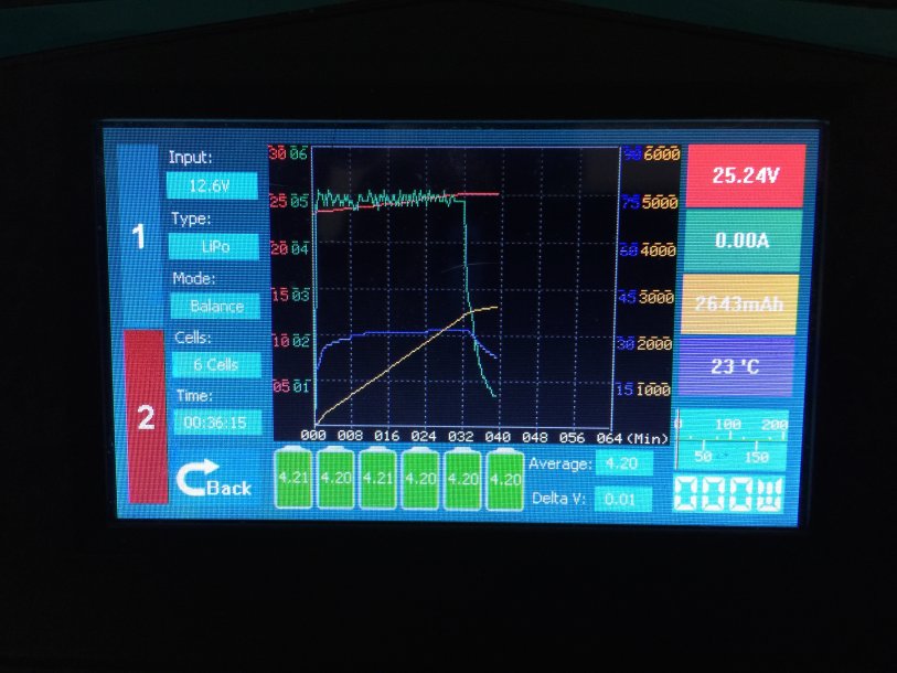

Avroto 3515
View attachment 21939 View attachment 21940
The Avroto 3515's used:
Batt 1: 2643
Batt 2: 2730
Total: 5373 for 5 min of flight time. (222 mah less than the U42's)

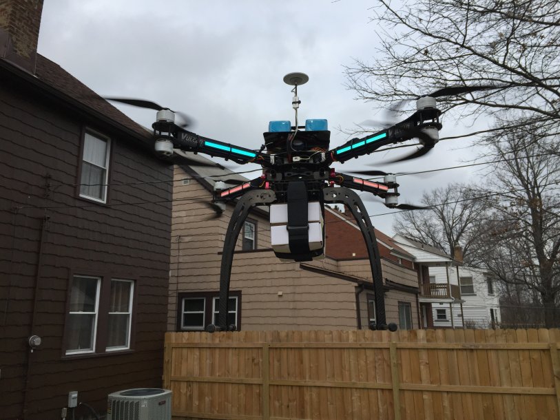

I did not have a second person to offer photo help for this comparison so here is a (grab cell phone while flying) pic of the trusty Vulcan X8 flying during the Avroto part of the test!
View attachment 21941 View attachment 21942
U42's
The U42's used:
Batt 1: 2687
Batt 2: 2908
Avroto 3515
Batt 1: 2643
Batt 2: 2730
