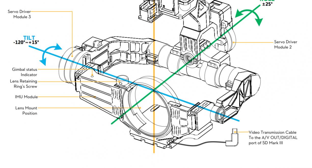

Thanks for your response.
Yes I am aware that a Gimbal fits only one type of camera. I'm considering just either a 5D or a GH3 (GH4).
However, I would like to avoid having to buy a lightbridge as I do not need to stream HD live, but just want to see what the camera sees, so I know when to take the picture or start recording.
So the question is, can dji 5.8GHz videolink accept the image signal the 5D send out, or do I have to have a lightbridge?
I have just heard that dji 5.8GHz videolink can only import an analog signal, and that the lightbridge can import a digital signal. As far as I can see, the output of 5D digital ....

There is a AV out connector, its a strange cannon cable that splits out, as far as I am aware that has a analogue av signal. Read the manual to be sure

OK but for Zenmuse be able to work freely, should I only use the cable that sits in the Gimbal, and not a loose cable from the camera to the videolink.

The Canon 5D mk3 connections are the same as the 5D mk2. There is both a mini-HDMI output and a standard four-pin video output socket. Both feeds are live when recording - unlike the Panasonic GH3. The GH cameras also feature digital and analog video outs via a mini-HDMI output and a weird proprietary connector. However, only the HDMI outputs whilst recording. The analog feed only works for playback of recorded files. An absolute waste of connector panel space.

Ehe ok so I can see what my 5D can see and record, just using the standard plug that comes with Zenmuse Z15 and 5.8 ghz video link with monitor, and therefore does not need a Lightbridge right....? :nevreness:
