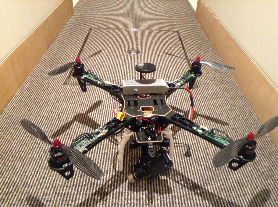

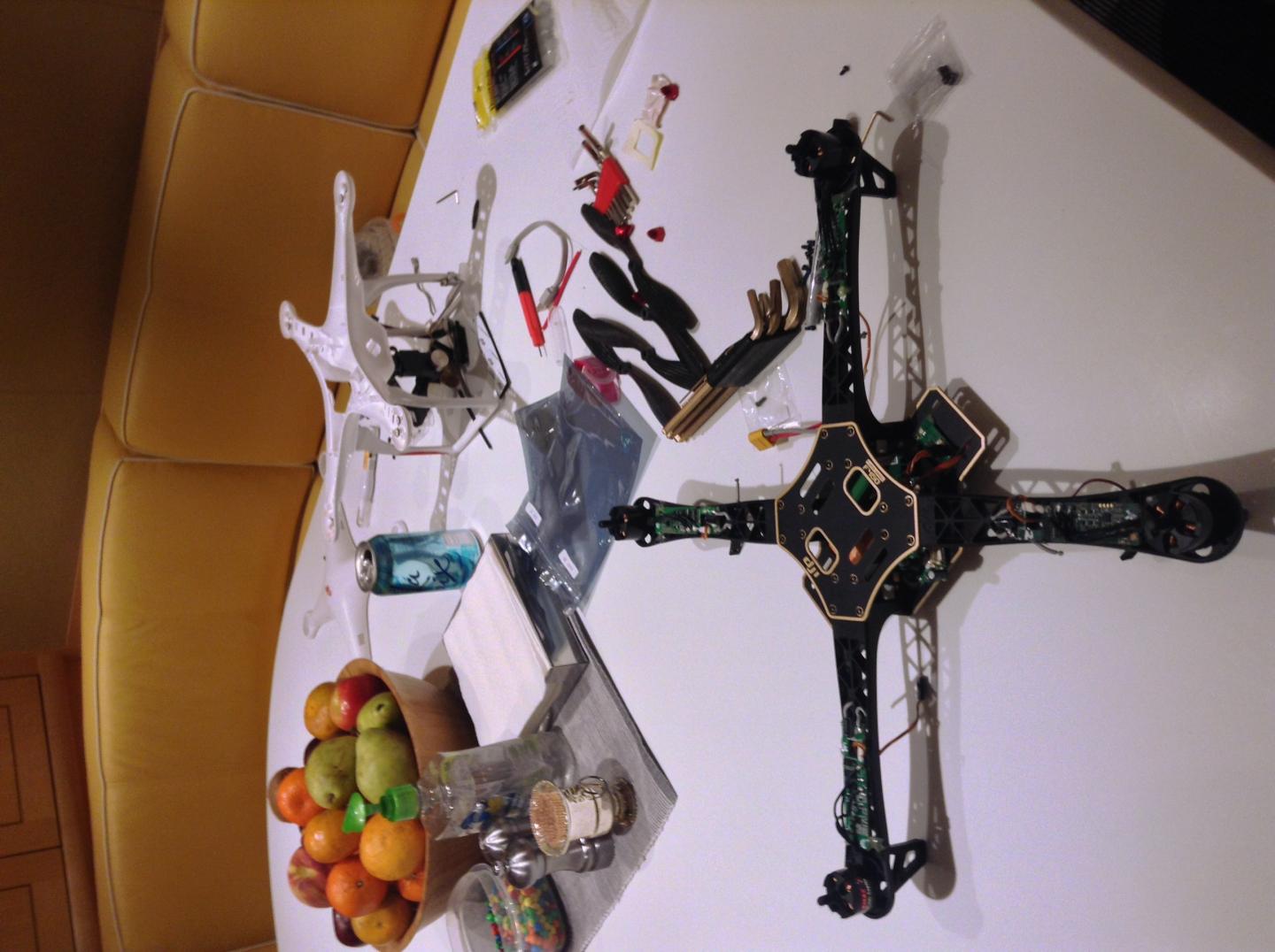

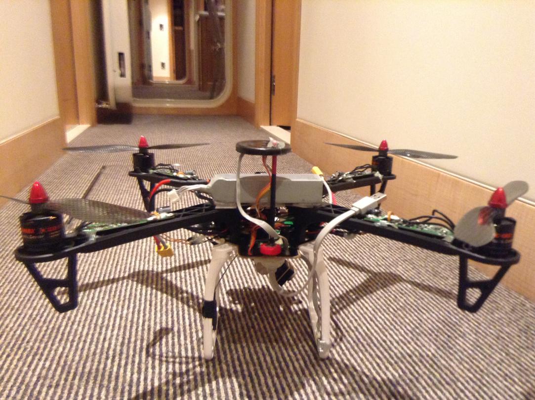

NEXT: with zenmuse etc the weight of phantom getting a little heavy and unstable, looked around online and a few people said technically its possible to transplant everything from phantom onto and F450 frame so i thought i would give it a go.
turns out it is, and is great in flight! so much more stable and rigid.
few photos below.
few photos below.
