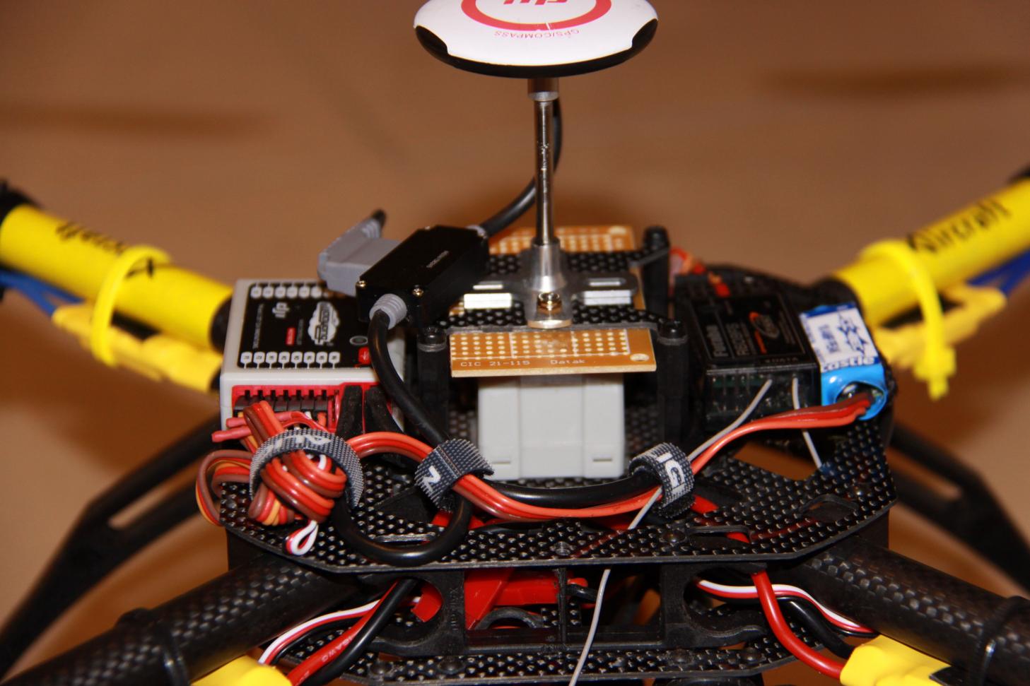

Guest

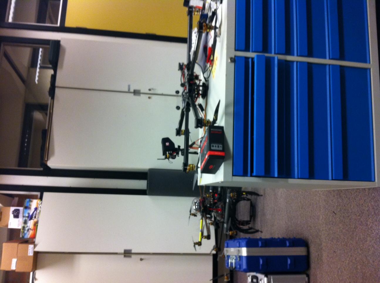

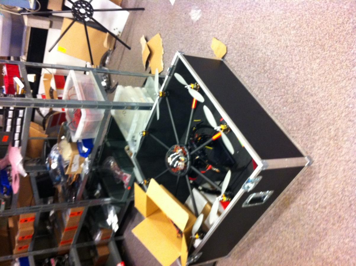

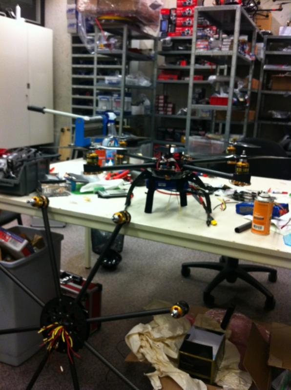

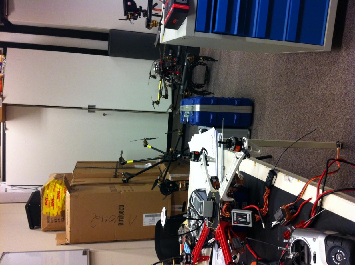

NOW I know u been on the Stella as they are all blurred!
