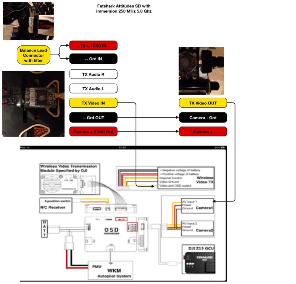

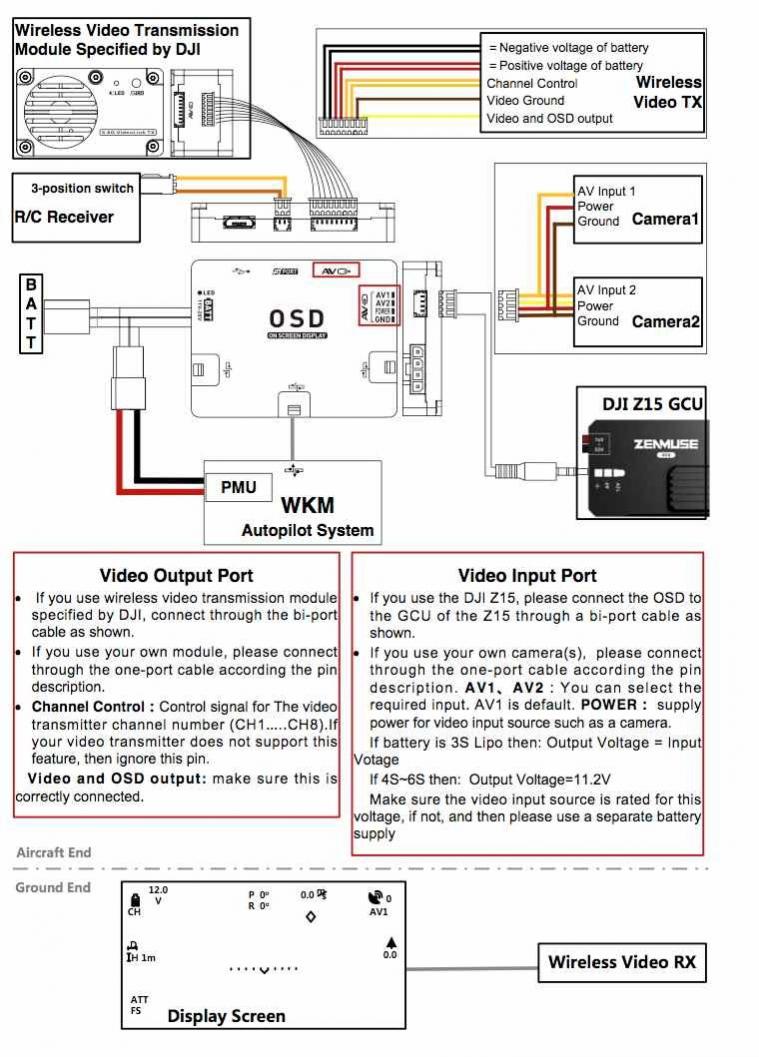

I've just got the DJI OSD (Wahooo) Anyone got a diagram to show wiring on Immersion TX.. I'm using the balance lead as the FPV kit has a filter on it.. Any help would be appreciated.
Vin :nevreness:
VINHEX
Just looking at wiring but not sure the best solution. Camera requires 5v but unit pushes out 12 to feed camera on 3S. Any Advice would be appreciated. Thanks
View attachment 7407View attachment 7408

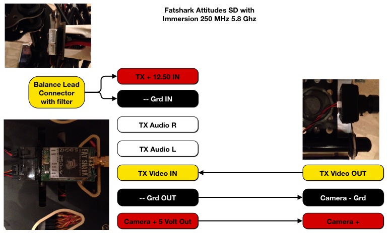

If I used the existing connections and only split to Video feed would this work? Still connect the power of the OSD as described in the diagram (DJI)
VINHEX
All sorted and up and running.. Weather not permitting to fly.... Arhhhhhhh
