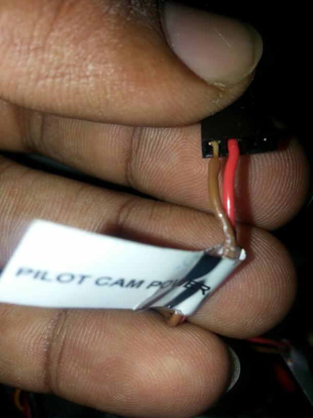

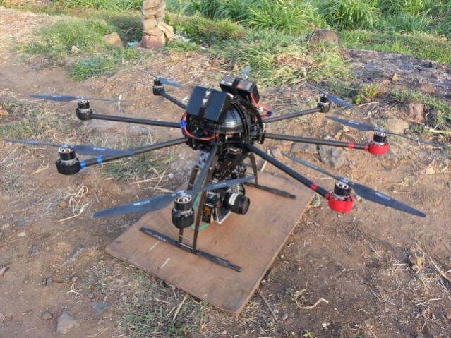

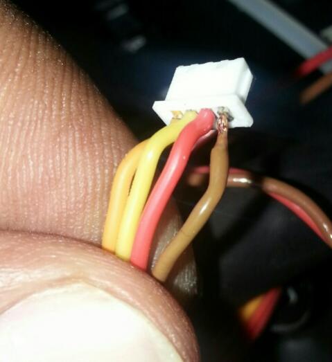

Hi, I've skyjib 8 TI-QR with A2, dji iosd mark ii, powerhungry board, 10900 6s battery all installed by ATI, Usa.
I recently find out that Dji IOSD getting hot and because of that it has melted av out ground cable of it.
I think its getting over voltage..
kindly give your suggestions to fix it.

Yes.. I removed all cables to check weather its heating or not but it heats up only with power connected. . And donno about wirings because ATI people did it
