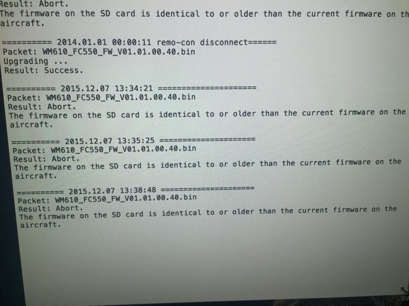

    Also they just upped the X5's bit rate in a update today.
    SO I'm looking forward to seeing what that looks like.
    But of course it's FRICKING DJI so even though I had a successful update I'm getting errors... :(
    View attachment 26983 View attachment 26984

    @SleepyC@SleepyC, read on another forum that the upgrade is for Inspire1 with X3, not X5, if that helps. Sounds like the same error message you're getting. Blade Strike and Tahoe Ed said you need to wait for the X5 upgrade...

    Well it was for the x5 too. I had to put my x3 on and then upgrade to the I1's new firmware and then delete the .bin file, install my X5 and all is right in the world. Ahhh DJI so much fun. But man does the I1 Pro fly nice. I added 14" CF T-Motor props. Holy balls. Smoother than any rig I have owned, or at least as smooth as my x8's.
