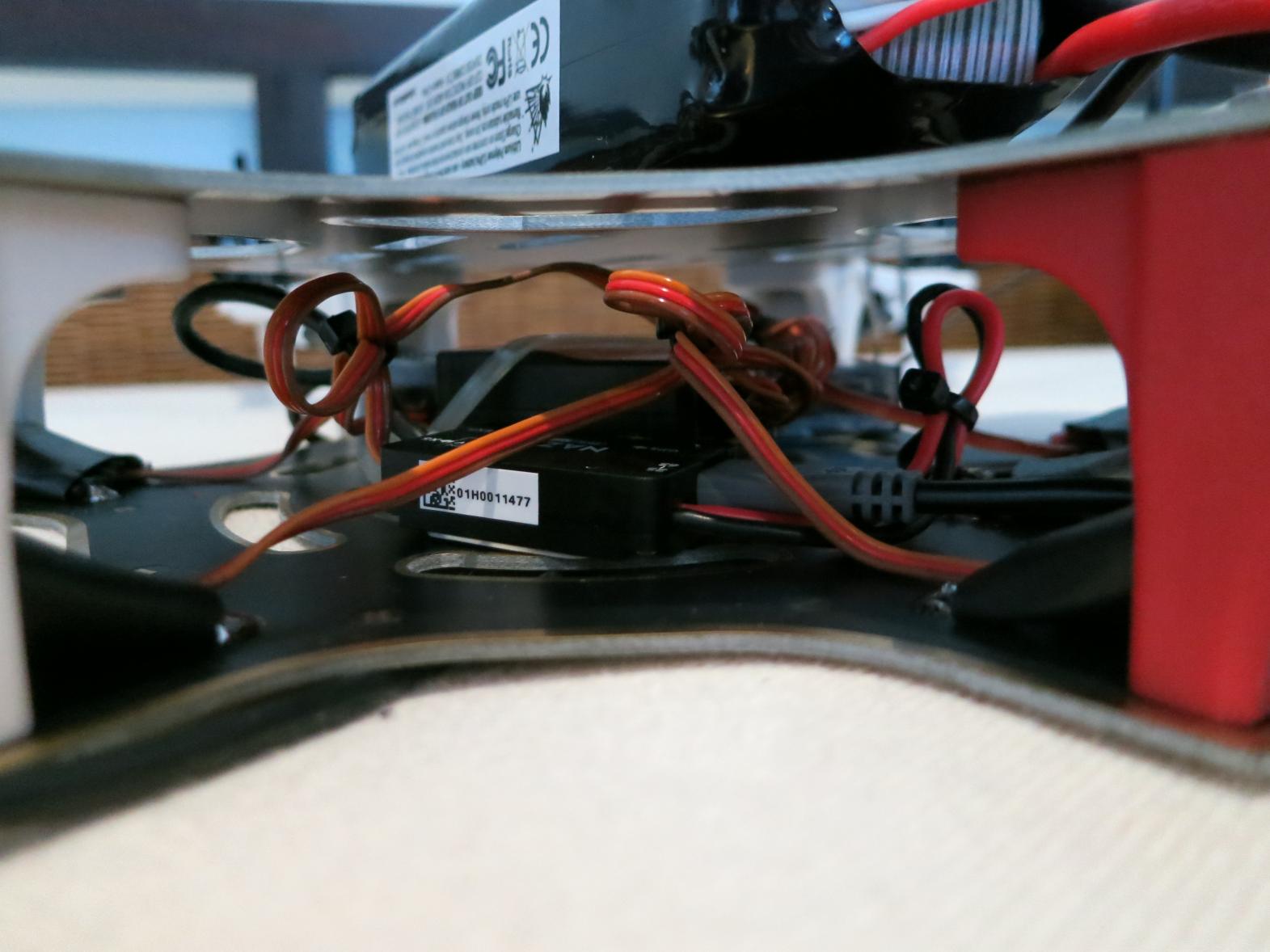

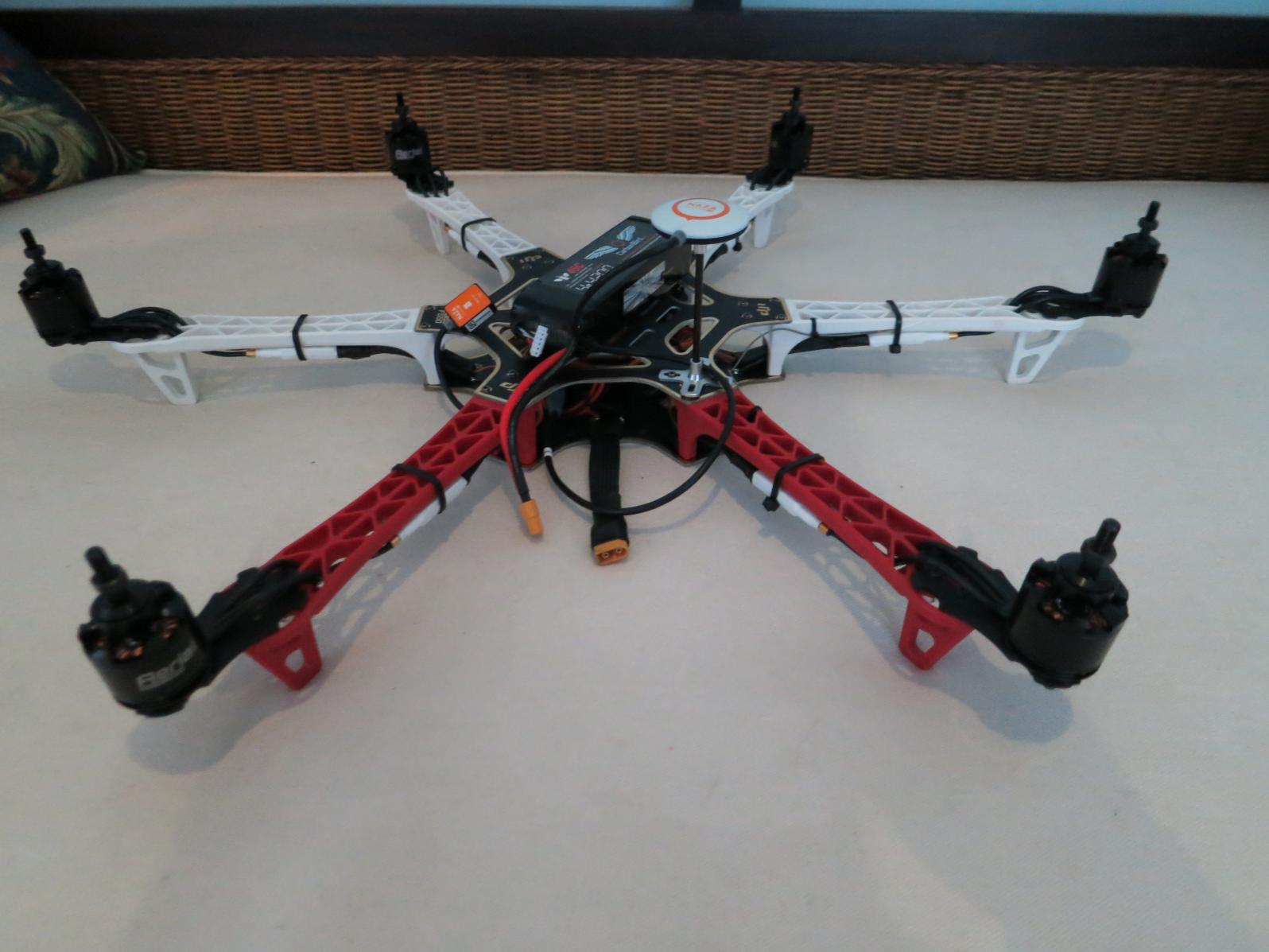

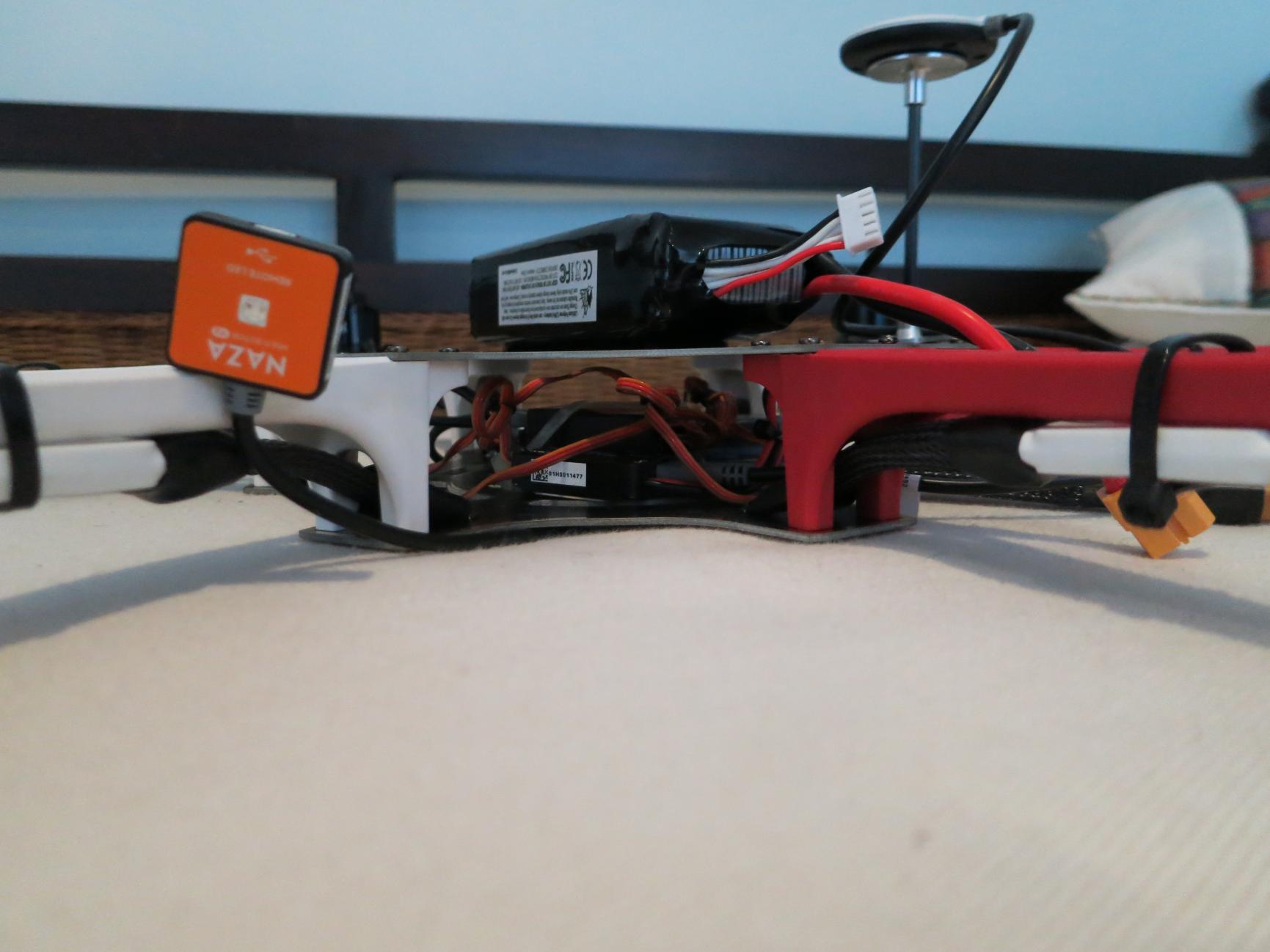

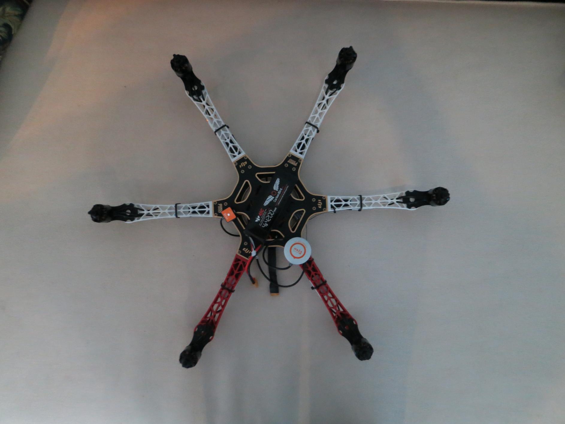

So most of my parts arrived today. Very fast and great service from Aerial Media Pros. Now for the real fun of assembly and flying.

Hi i do have a question regarding the GPS antenna. What adhesive do you use to attache the little pole? I have attached the bracket to the frame OK but unsure what to use to secure the GPS and pole as I'd like to be able to easily remove it for transport but needs to be secure during flight so it wont shift etc.

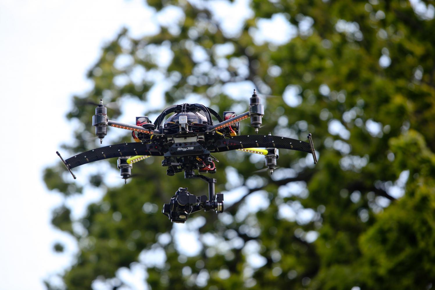

The build went really well thanks. since building it I have changed the arms to the Aimdroix arms (there is a thread on this forum about them) this has proven to be much more stable. I have added the Gopro Zenmuse as well which is a great gimbal. I am getting around 10min flight times. I also put on the DJI made landing gear which are fine but there are lots of options out there for landing gear.

The AMP motors are very good, they have been very reliable and sturdy. I'd like to try a lower KV motor around 400KV with larger props. But the AMP motors have plenty of lifting power, and moves along quite fast. My AUW with Gimbal but without batteries is 2174g. With 2x 4200mah batteries I am getting about 10min flight.

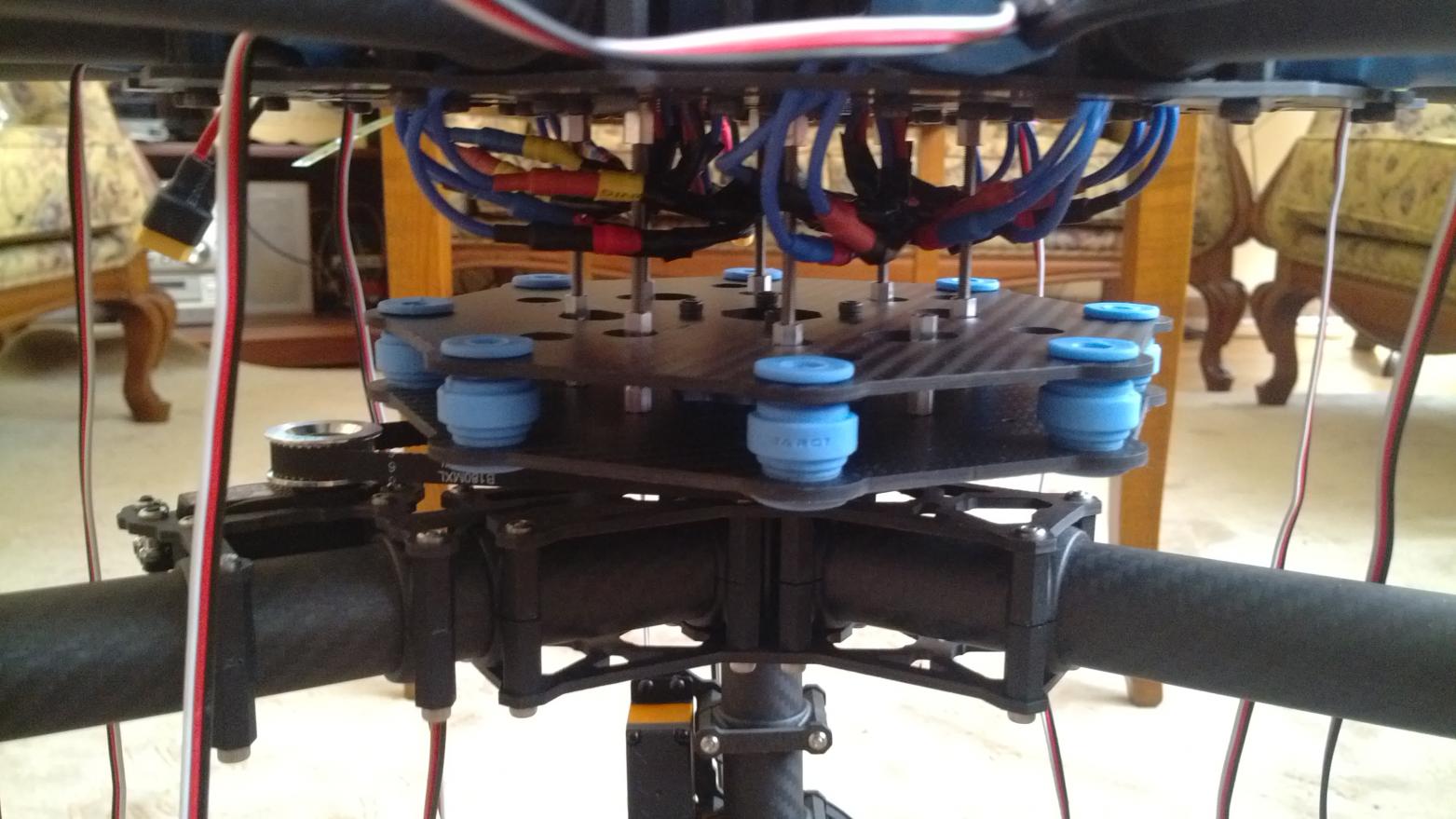

When upsizing the motors and props for an F550 be very cautious with the motor and prop balancing.....
The FC does not like vibration which can lead to partial flight control, random altitude loss and gains and potential fly-aways.
Even when well balanced I had to use Kyosho anti-vibe tape under the RC receiver and FC to guarantee long term reliability.

Its always best to elminate the problem at the source, i.e., eliminate all motor and prop vibrations by balancing......
You can hear it and feel it when you touch the motor arm with that motor spinning.
Once the vibe is almost eliminated, the motor sounds very smooth and you can seldom notice the vibe when touching the motor arm.
In cases where the vibes are impossible to eliminate, check the motor bell for runout before attempting to replace bearings.
I use the Iseisometer app for a smarthphone, Apple or others..... The Iseisometer app uses 3 accelerometers.
Of the 3 axes the one that is most relevant is the axis that is parallel to the MR circumference (not perpendicular).
When that vibe is resolved, the other two tend to minimize as well.
Always balance the motor first then balance the props separately with a prop balancer. And if the prop center hole if off... throw it away.
When you see a lot of accelerometer vibration you can empathize with that the flight computer sensors have to deal with.... if excessive, the FC cannot possibly determine how to sort out the needed acceleration from all the background noise, i.e., motor and/or prop vibration......leading to strange flight behaviour.
Where it is not possible to eliminate all the vibrations it might then become necessary to install the Kyosho antivibe tape under the FC as well as the RC receiver. I do both because I know that vibration kills RC recievers eventually.
