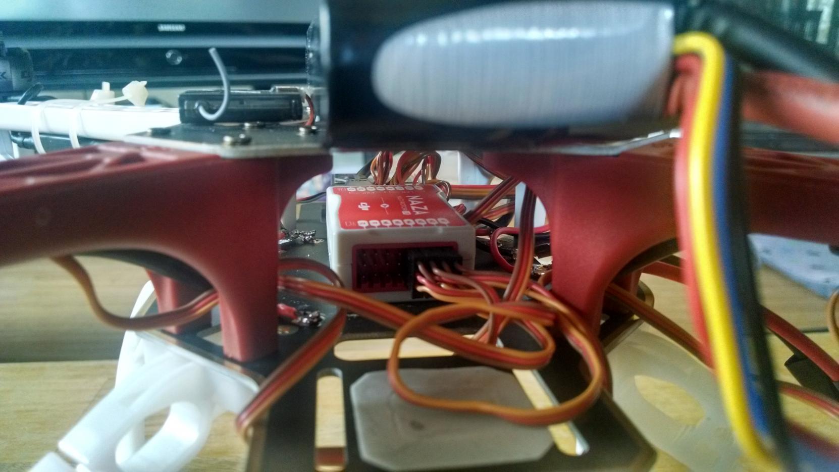

Just built my F450 and I can't get it to lift off.
Notes:
It always tips backwards, if I give it more thrust it will flip backwards
I've calibrated the GPS a few times and no change in behavior.
IMU has been calibrated.
Motors are confirmed to be in the correct position and the props are rotating correctly (This kit doesn't let me put the props on the wrong motors.)
I've moved the naza closer to the center of the copter.
Video: https://www.youtube.com/watch?v=ct9NZBLDA0E
(If I give it more thrust it just flips all the way over.)
Pics:
http://imgur.com/a/vJOIo
Any help would be appreciated!

Certainly the props are at fault, wrong way or your motors are turning the wrong way. Just looking at your picture, please fix that soldering and secure the wires from the Naza, them jumping around can make them break early and knocking on the Naza with mess with the sensitive sensors onboard.

If you are sure everything is correct, the only other thing it can be is your FC is the wrong direction, not knowing the front from the back, but seeing your battery leads exit that way, I would say your FC is backwards... ESC's outputs to the front of the Multi Rotor.
That solder joint behind the FC is not fine, it will vibrate and break off. It is your money in the air and you should do as you want with it, but my advise would be to shorten the amount of wire and keep it close to the joint as possible.
