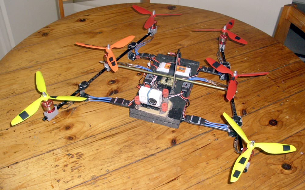

The heavier the machine, the less efficient it will be. A hexacopter will be more safe and controllable than a quadcopter. If one motor or ESC will fail in flight, you will still be able to land the craft. For a 3-4 lb hexacopter, I would suggest to use 1200kv outrunners and 8" x 4" props. The battery could be a 11.1V (3S), 3300mAh, which will give you about 8-10 minutes of hiovering flight. I just give you an example: this is one of the hexacopters which I have designed and built. It is flying very well, using six Emax CF2822 motors, six SimonK 20A ESCs and a CC3D flight controller. The camera is a Xiaomi Yi with a linear lens. On this one I started with three blade props, but I found that two blade APC thin electric or multirotor props are far better balanced and more efficient. REMEBER: VIBRATIONS ARE YOUR ENEMY! YOU MUST DO YOUR BEST TO AVOID THEM.
Cheers from Bruno
