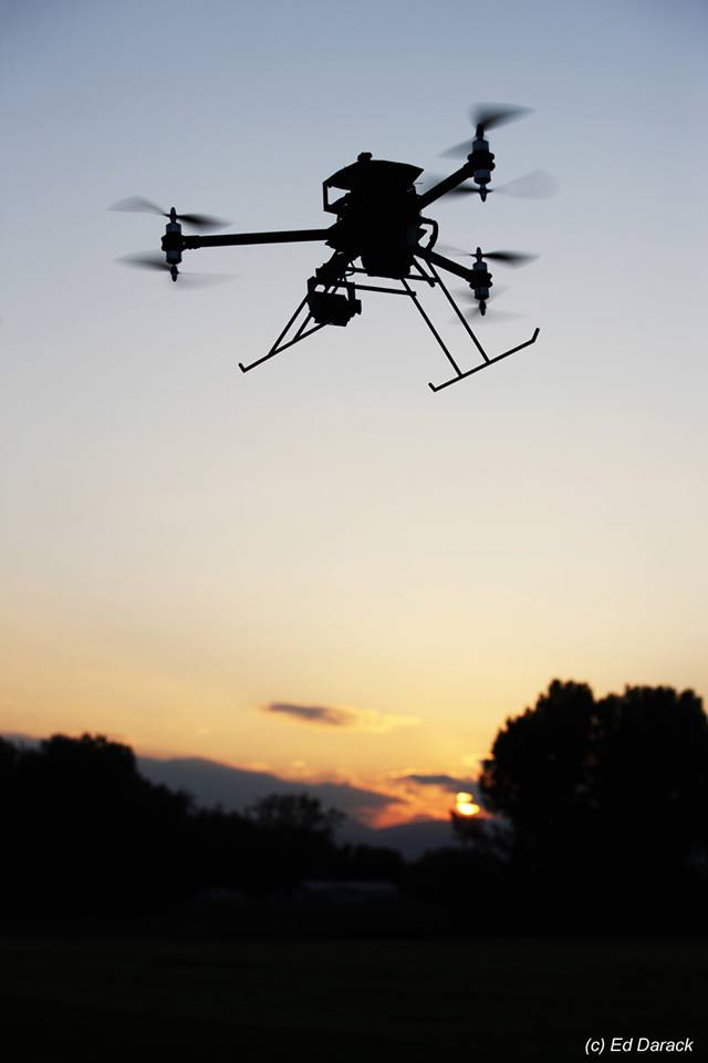

I've been flying my recently-completed Y6 a bit. I had everything trimmed out where it was very smooth flying with auto-level enabled. I took it up to about twenty feet and enabled position hold (GPS showed green, a good fix). It stayed in place, and made a slow counter-clockwise circle with a radius of about ten feet. When it completed its circle, it flipped and came crashing down. Thankfully, the frame is just slightly broken, and everything still works. Auto level was enabled, and I had it in position hold mode. I was not making any control inputs. Would the altitude hold gain have anything to do with this? Here is a video, taken from the Y6, when it happened:

Here it is before it tumbled to the ground...
