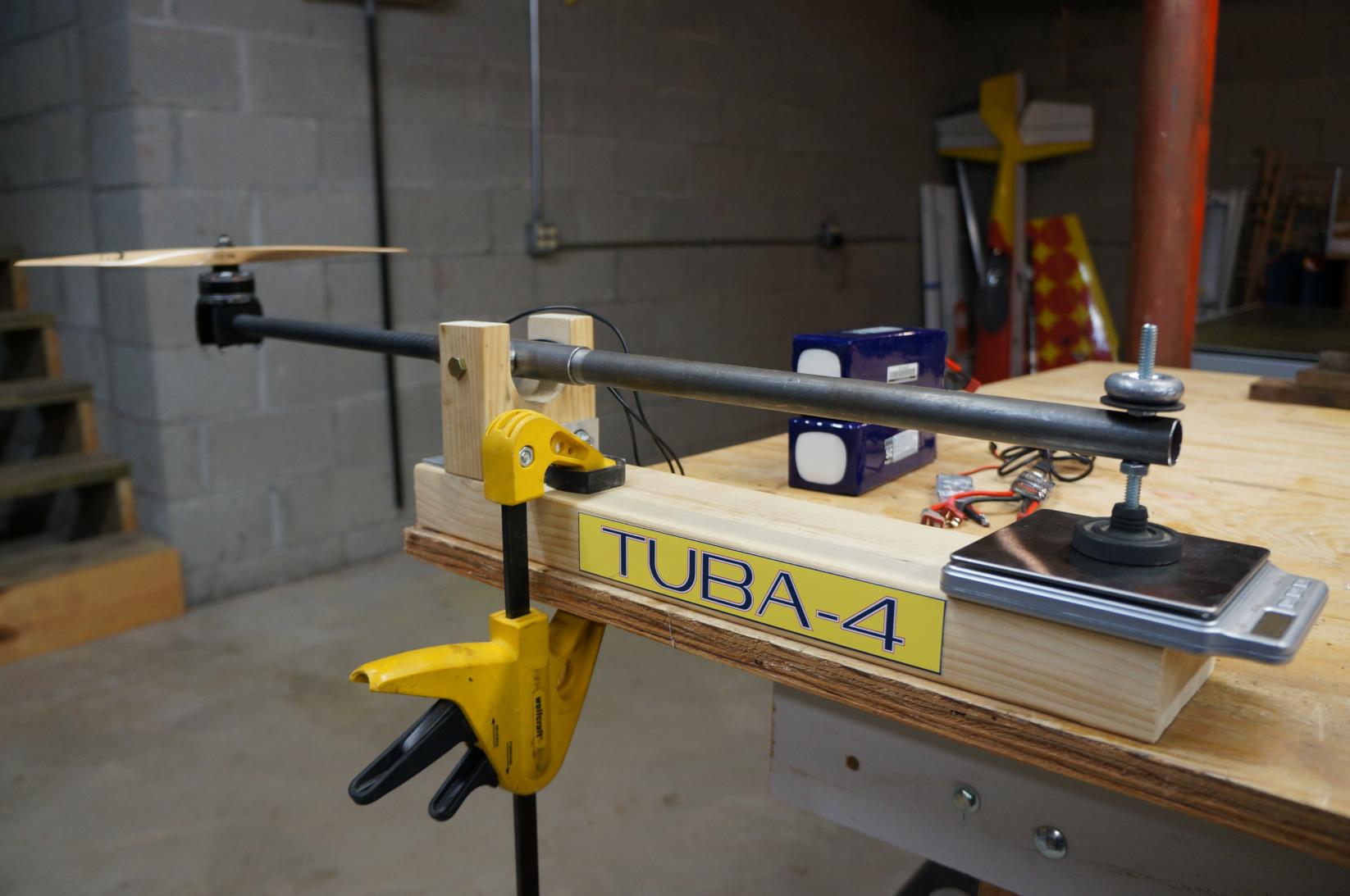

This isn't a build for someone else, it's for me, for fun, because I want to go really fast. :)
also, anything for a new heli will be run on the world famous Tuba-4 motor test stand. :tennis:
Okay, that's groovy- apologies if I came across a bit negative but I too often scared by what some people are trying on this forum without having sufficient knowledge. Having now recognized the TUBA-4 you are clearly not one of those! I take it you will be flying this in manual then as atti and GPS modes by limiting the angle of attitude will limit the speed regardless of the props unless you want to see it rocket skywards at the same time
