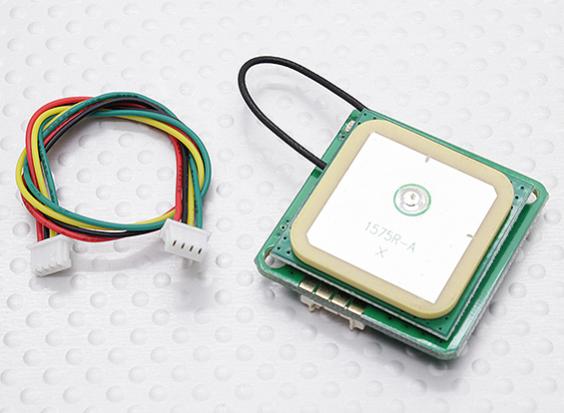

I'd start by opening the puck to check for cracks in the GPS module.
If it broke the stick it could have damage.
Don't worry about voiding the warranty, It's Chinese, there isn't any warranty. :upset:

Hi Just to update you.. I decided to take the plunge and by a new GPS compass.. this now appears to have solved the fault as now I have all green lights Thanks for all your replies
