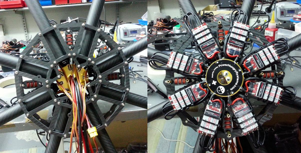

Finally we come close to perfection almost like Zenmuse.
Cinestar 8 + CS gimbal 360 pan + Radian
DJI, KW8 motors + xoar 13x6,5, KW60 esc, powerhungry board.
Lumix GH3 + GX Vario PZ 14-42mm OIS panckage lens 1080 50p
Perfectly tuned, no poststabilization, raw files, just cut.
Hover with GH3 - 42 amps, 2x 5s 8000, flight time almost 20 min.
