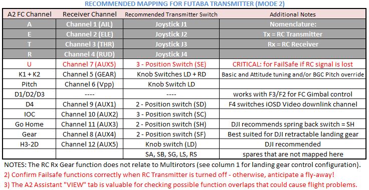

Previously when using a separate RC Receiver with my WKM, I simply would connect a spare Rx output channel directly to my BGC so as to remotely control the camera pitch angle. But with the A2 built-in DR16 receiver, how do I map it so as to do the same?
Here is my complete RC + DJI A2 mapping configuration...View attachment 17663
