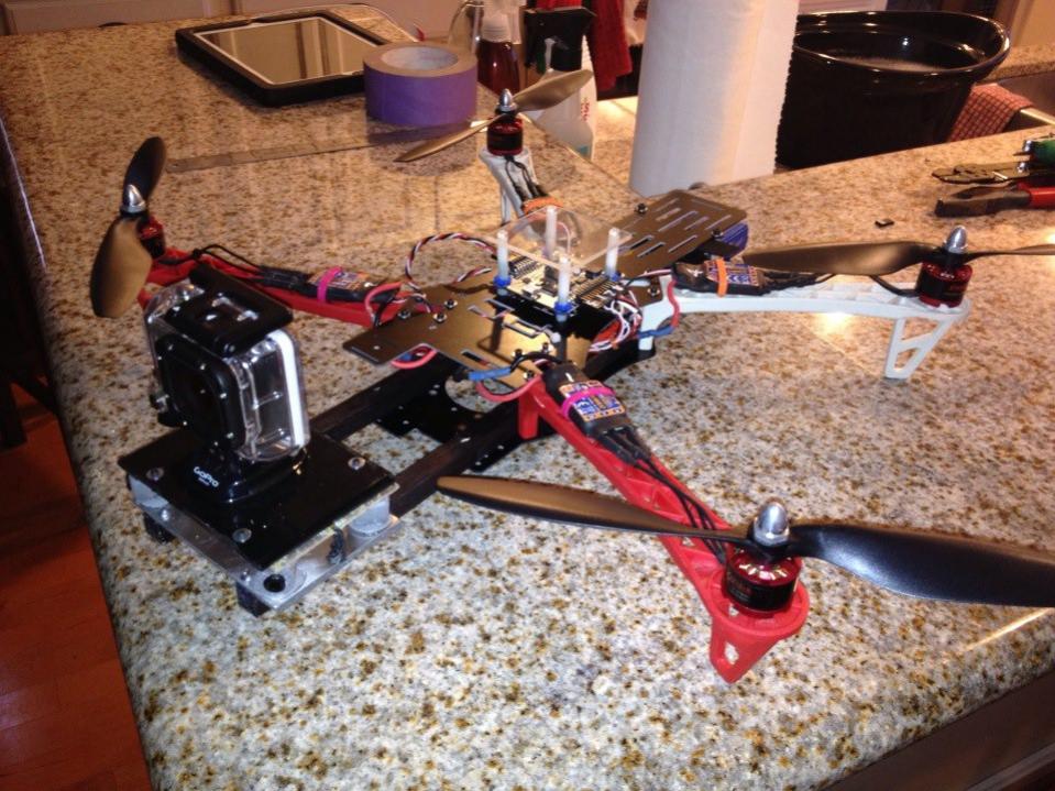

Ok.. so I built up a smaller rig to be able to do some indoor filming in tighter spaces. (A print show wants me to do a production floor run from above capturing the LONG 6 color presses)
I built this guy around a HF Sport board flashed with the latest AV rom.
I pulled the 20 amp ESC's from another rig, and the motors are DJI wanna-be's but work great.
The quad is balanced by the battery pack in the back to compensate for the camera being out front.
Although it seems like the HFSport is doing it's job to be very stable, the throttle response is crap. It's almost like a light switch.
Off or on... the throttle has a linear curve set up on the radio and the rest of the programming look sjust like my other Y6 program which flys great
The throttle travel is set to L100 - H100. The esc's on the last model were very smooth with different motors.
Is there an esc calibration I need to do with the sport? Something to define the low and high points of the stick movement? Or a calibration I need to do with the ESC"S?
I did not have to do this on my Y6 with the HFSport board, and it's throttle response is flawless. I just plugged it in, and adjusted the gain and it was awesome out of teh box.
Any thoughts?
Here is the rig.
