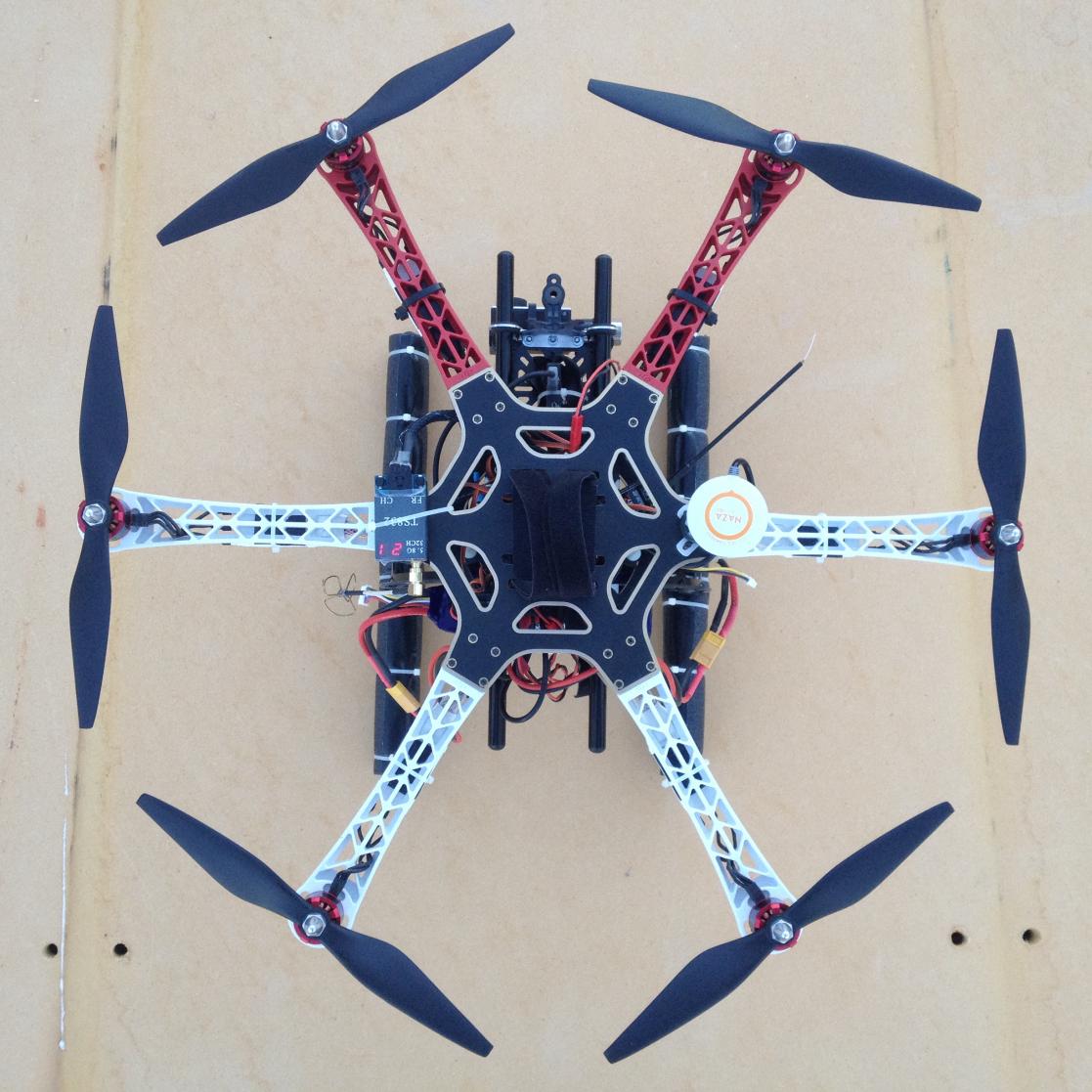

The group build thread is now long (54 pages with 536 posts), but I was there at the beginning and it was very helpful. I am interested in building my own multirotor and after following the posts I started to plan my first build. At the time there was a DJI F550 package that was offered: it included a landing gear, a gimbal for a gopro (that could be used as an FPV system), a Naza version 2 set-up. I added a video transmitter, a diversity monitor with built in receiver, and a good radio. I powered it with nano tech 4S 6000 mAh batteries that I used as a pair (don't forget a charger). Later I bought a aeroxcraft landing gear set that acts as a platform for the GoPro gimbal and a battery holder that is relatively easy to balance. I would also suggest that you establish a rapport with one or more of the vendors listed on the forum if possible. In my brief experience building multirotors; there is no 'one-stop shop' for all the parts that you will need so there will be a whole suite of stores to look through. We stand on the shoulders of remote control aircraft enthusiasts (and their vendors); it has helped us out and affords a lot of choice. Also the most important for me is to keep a document log of what you read and the associated links that are important to your specific needs and interests.
I have moved a few things around on my F550 and got a better position for my video and receiver antennas, and added some telemetry. Flight times for me with the bare bones system were about 19 - 20 minutes, now with the fully dressed system it is 13 to 15 minutes. I have had a few crashes, especially when taking off and flying contours, as well as some hard landings. Part of the learning curve and a reason to start simple; your AR Drone may have helped you over this.
I hope this helps -
Here are some photos of my F550 rig:
View attachment 17986View attachment 17987View attachment 17988
