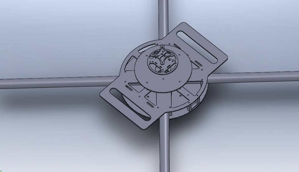

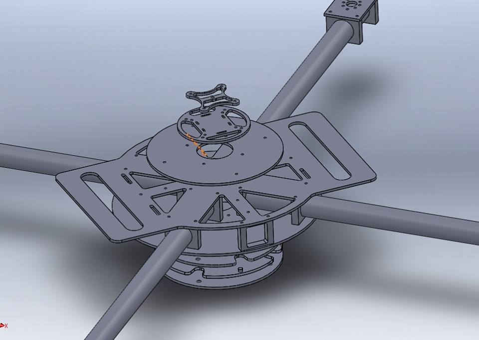

In house made! Yeah, we spent over few weeks to design frame for our X8. Good friend of mine is SolidWorks expert so I had chance to work with him and make ultimate frame designed specially for our components. You can see few screenshots of drawings, but take a note that these are not finals!
Some specifications of the frame: 25mm PA6 clamps, dual motor mounts made of alluminium, side battery try, bottom ESC and power distribution mount board (they are far far away from electronics - you can never know!), plate for IMU mounting, top plate for GPS mounting, 2 stage antivibration system using custom dumpening material, etc., etc...

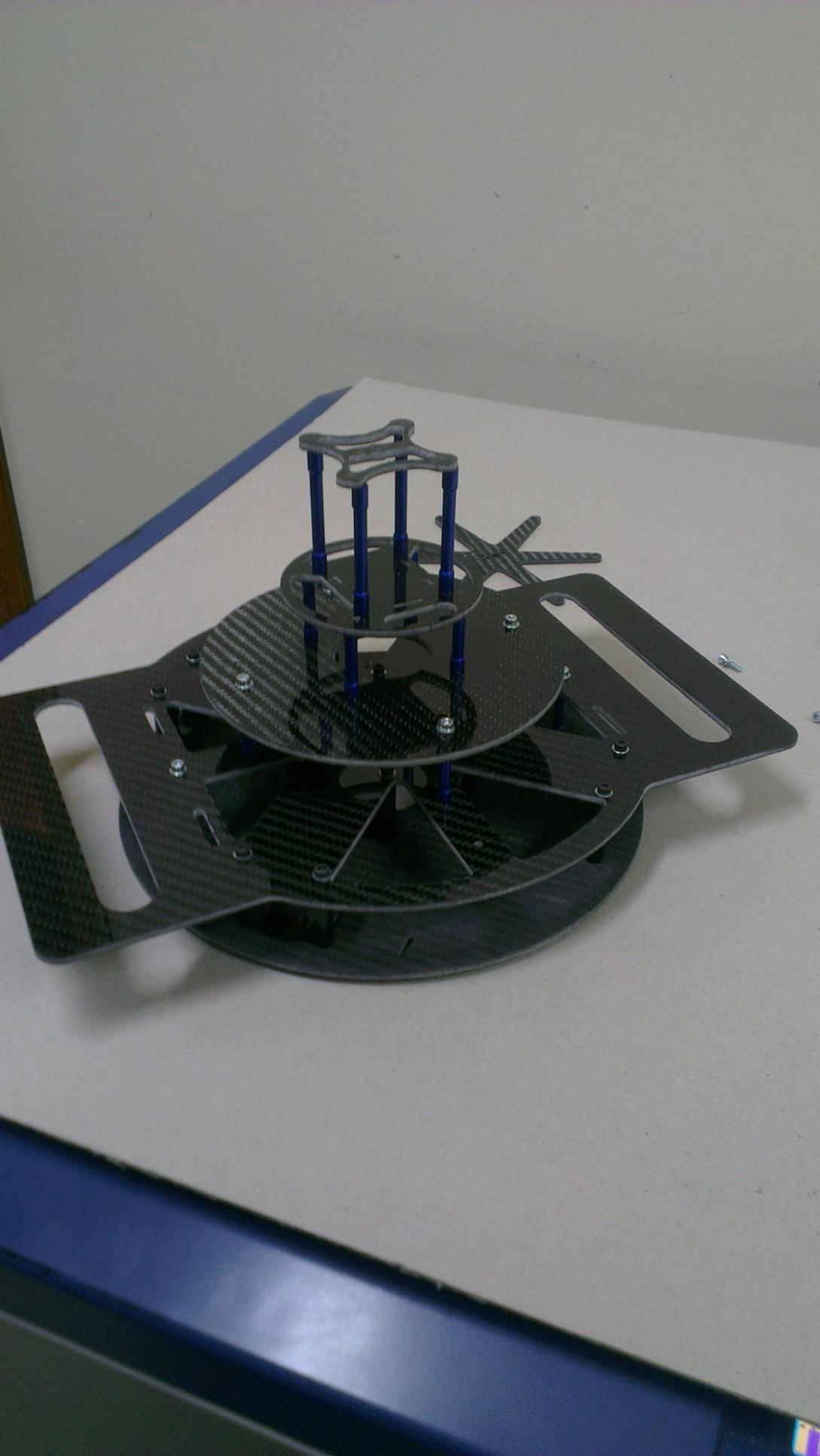

Some of the process has been made... :)
Here are two pictures, first one - cutting carbon fiber on CNC and on second one are center plates with three levels for electronic. I am in doubt about last one since it is only GPS mount, maybe GPS will go on the arm?!
Still waiting for the booms to arrive, they should be here tommorow so then I will start soldering motors and ESCs. More pictures coming soon :)

airship
nice ;-) but please use a vacuum cleaner while cut the CF !!! the powder if really dangerous for you first and for the machine
