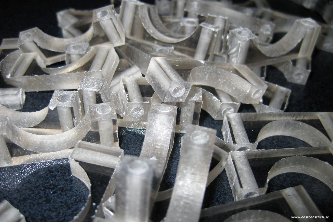

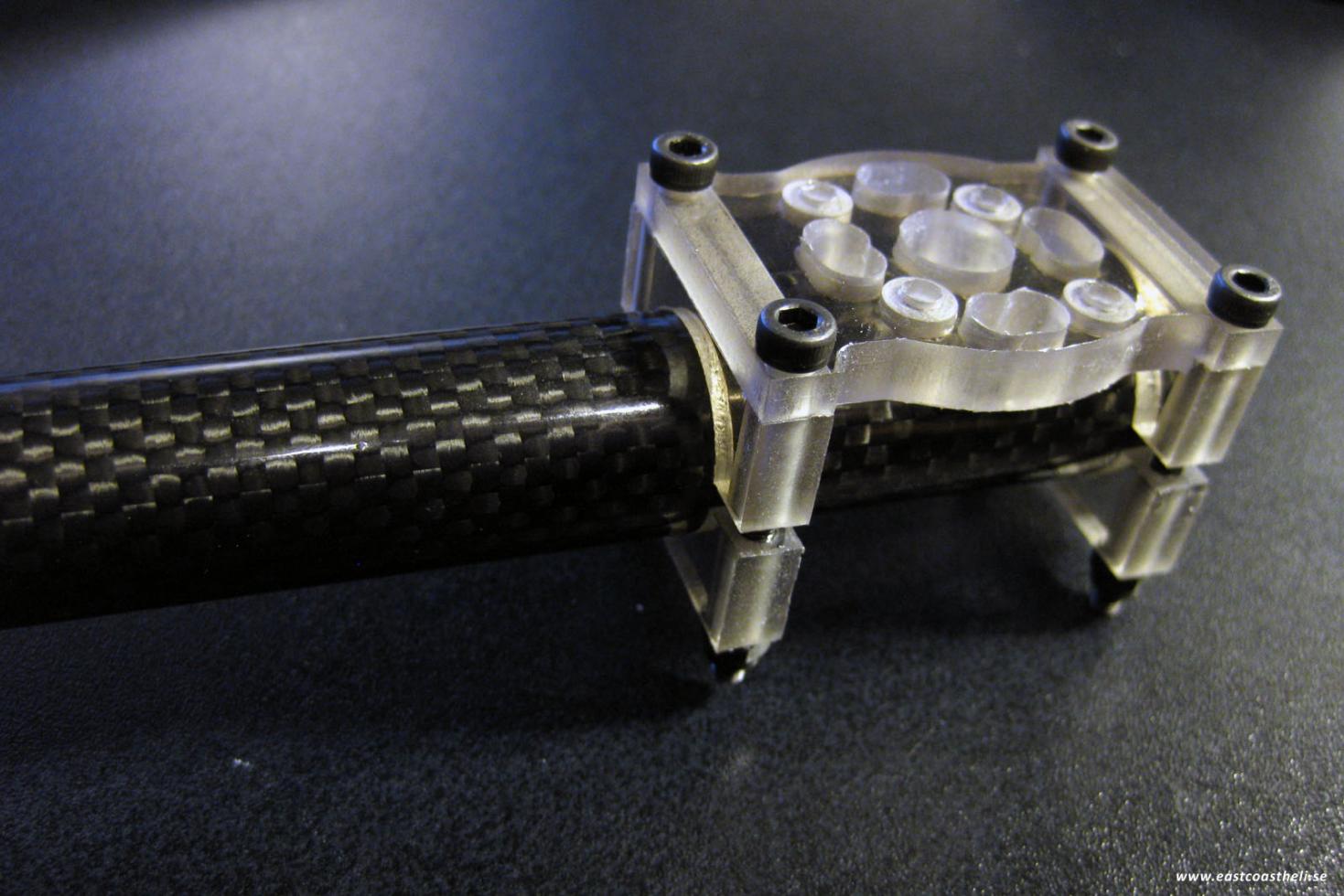

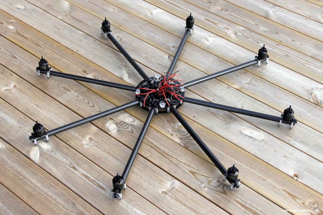

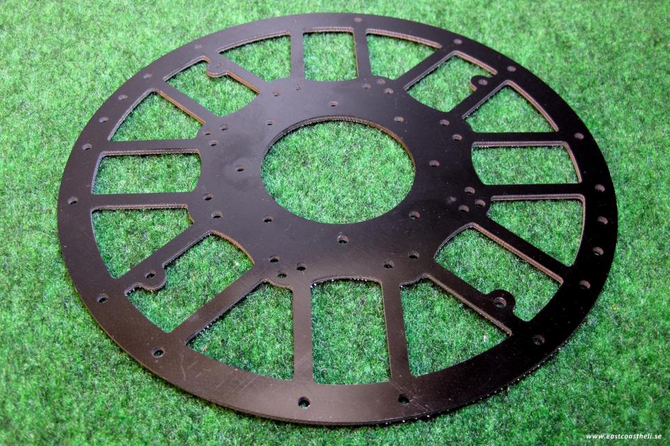

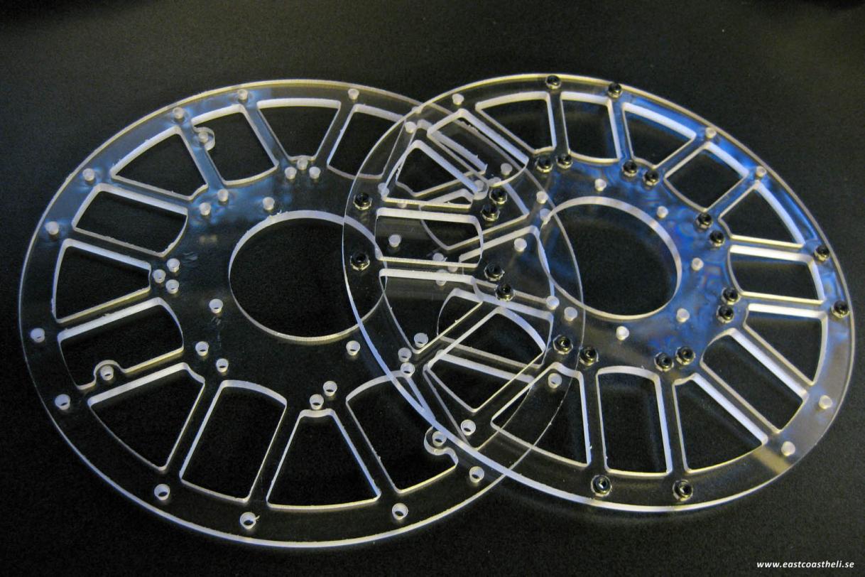

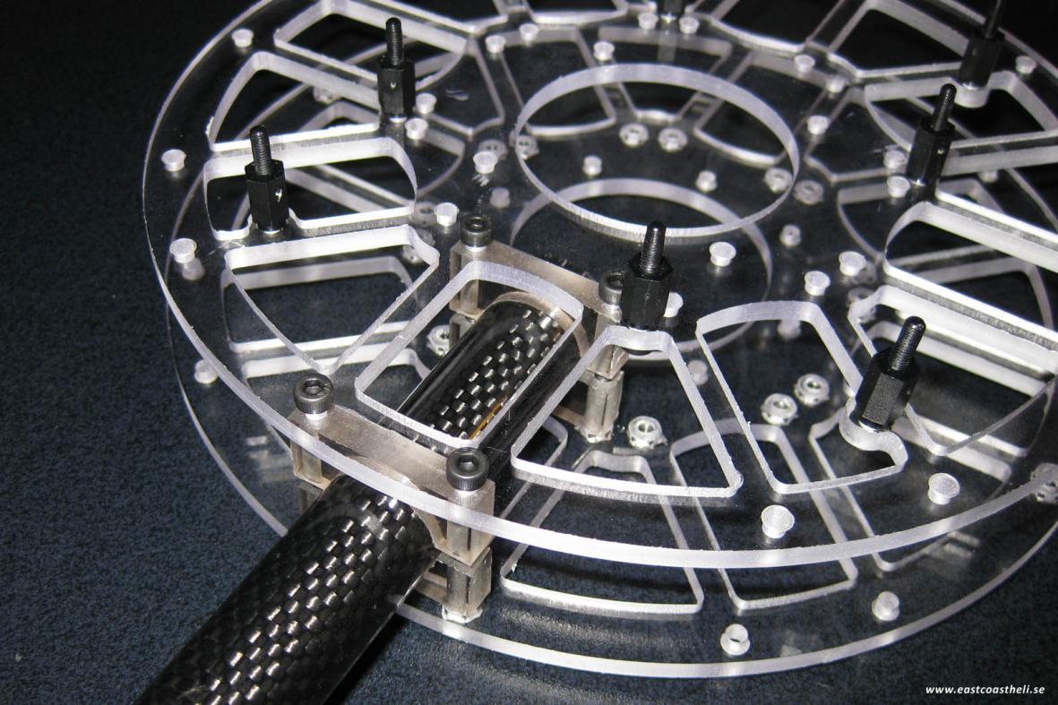

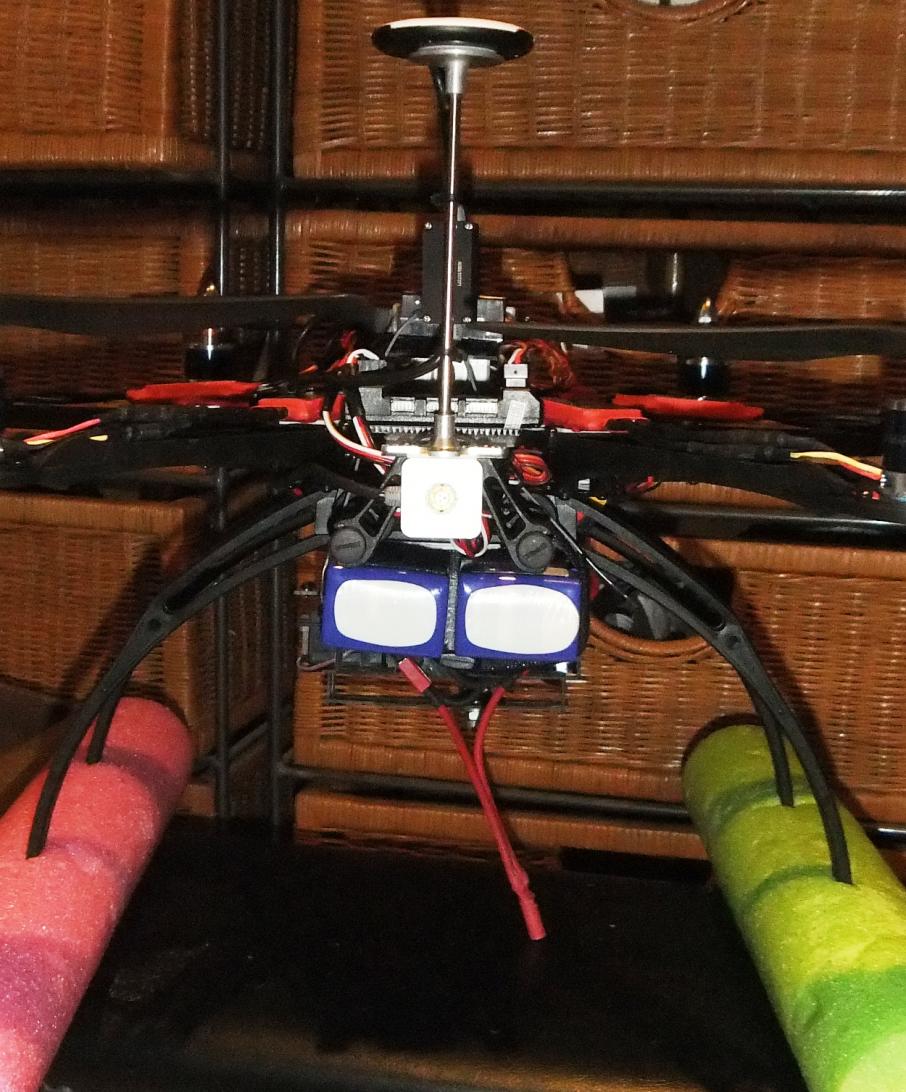

At first I was sure it would take lots of work to build an airframe and I didn't think I could do it myself, but it's really easy if you go about it right. The main thing is to try and keep as much of the weight off as possible, which it looks like you have done. It also looks like you have used captive nuts there as well, a nice touch which makes fitting a whole lot easier.
Well, I hope your build goes as easily as mine. Keep us up to date on the progress. Mine will have a slight facelift in the next few weeks, so I will be busy again :)
Gunter.

Hi Drhswe,

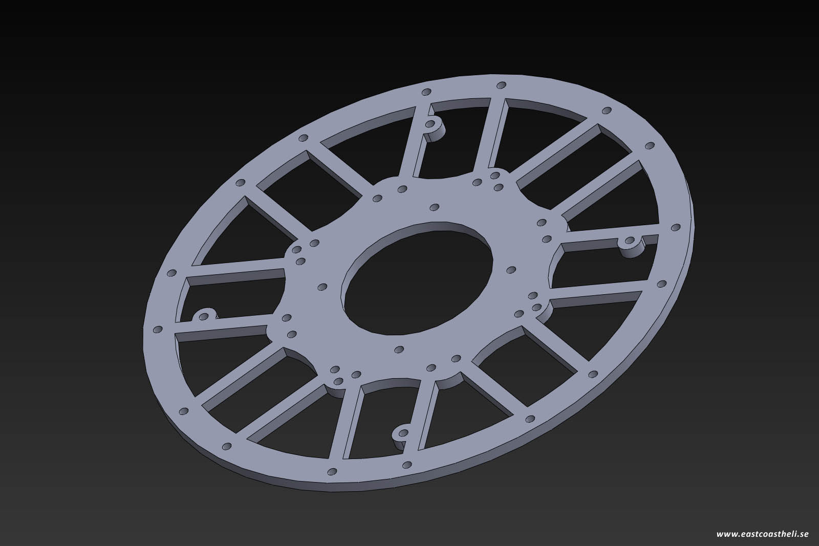

are you prototyping at the moment or is the centerplate the final material you will be using. If yes what material is it ? Nomal Acrylic ?
thanks

A bit of both, it is a prototype that can be used.

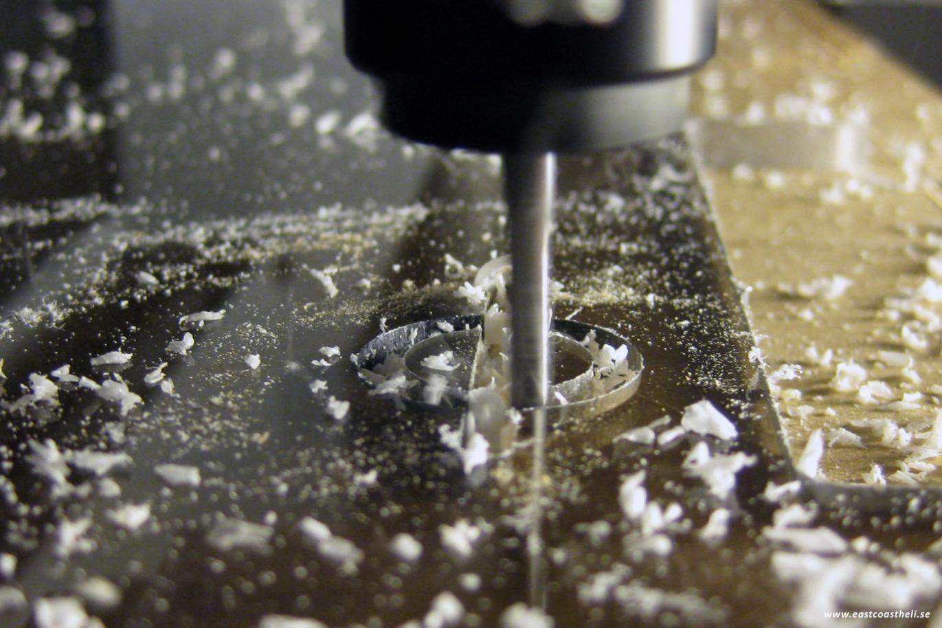

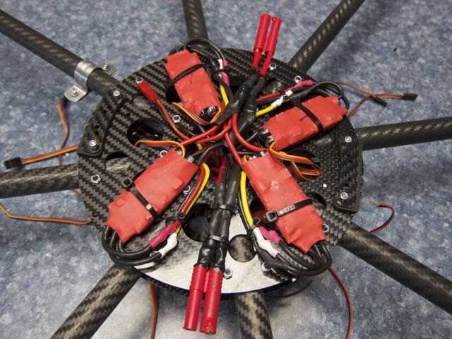

The center plates are made of 4mm Makrolon, "the high-tech polycarbonate". It's realy superstrong.
My engine mount
6mm Makrolon

Love those boom end plugs.. nice finishing touches.. looks the dogs jobber... be interesting to se how the plycarb handles the vibes.. where are you getting it from and where are you getting the carbon tubing from?

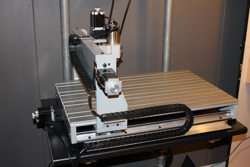

U using a CNC cutter?

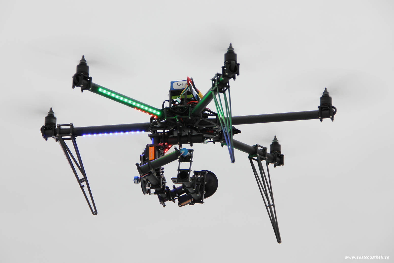

Hi, sorry for being away for awhile.
Too much work and to many projects at the same time...
One of them: http://www.multirotorforums.com/showthread.php?2069-Build-(picture)-log-CineStar-6
I have also built a QUAD in Makrolon, I will put up a thread later.
@ Droider - Yes a CNC cutter. I'm getting the Makrolon from a local store. Carbon fibre - ebay.
@ Gunter - Motor distance ~100 cm

BTW, did you drill the holes on boom clamps manually? If the CNC machine did it, what kind of machine did you use?
