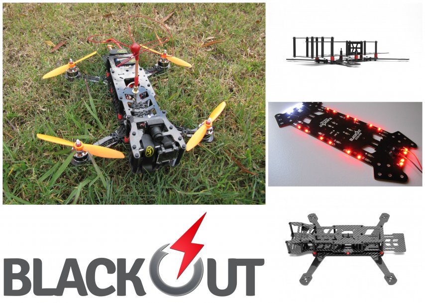

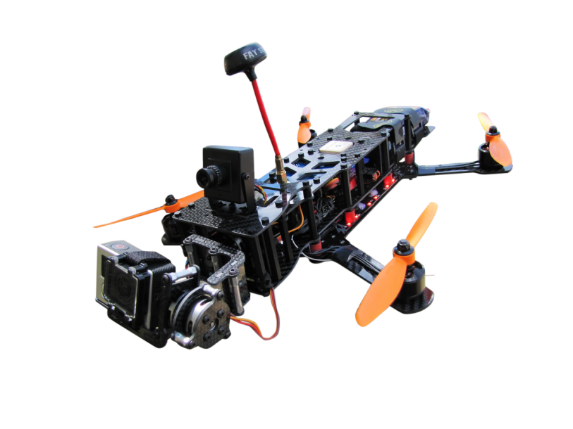

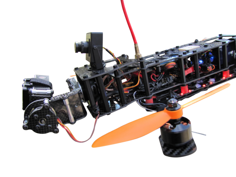

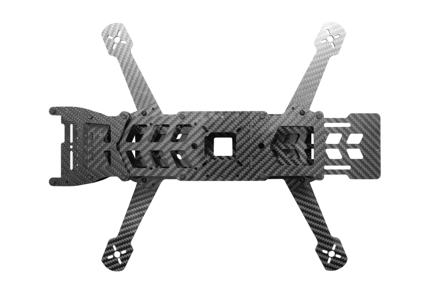

THE BLACKOUT B330 / B360 HAS BEEN DESIGNED AS A FAST & DURABLE LARGER FPV RACING QUAD.
Being slightly larger provides more stability at high speeds and allows room for UHF and powerful 1.3ghz video transmitters. The frame design surrounds your GoPro ensuring maximum protection.
Easy to build with the provided Power Distribution Board. Clean/Dirty section for anti-vibration.
The Firewall offers protection to your electronics from battery movement during hard crashes.
The Blackout 330 has been designed as a durable high speed racer. Being slightly larger provides more stability at high speeds and allows room for UHF and powerful 1.3ghz video transmitters. The frame design surrounds your surrounds your GoPro3 ensuring maximum protection. Easy to build with the provided Power Distribution Board. Clean/Dirty section for anti-vibration. The Firewall offers protection to your electronics from battery movement during hard crashes.
Goals
  • Durable
  • GoPro 3 located in the center with protection
  • Clean / Dirty Section
  • Gimbal carrier
  • Maximum Performance
Specifications
  • Frame Weight: 270 grams
  • Size: 330mm MTM
  • Materials: 3k Twill Weave Carbon Fiber
  • Fasteners: Zinc Plate Alloy 12.9 & Black Polymaide GV
  • Maximum Propeller: 6"
  • Motor Mount: M3 16mm - 19mm
  • Fight Controller Mount: 30.5mm x 30.5mm, 45mm x 45mm & HKPilot
  • Board Camera Mount: 32mm x 32mm
  • GoPro Protection: LayerLens
Suggested Components
  • Motors: Cobra CM2208-20 2000kv & Tiger MN2208 2000kv
  • Prop: HQProp 6x4.5 2 Blade
  • ESC: HK Blue Series 20amp & 30amp – SimonK, Afro 20amp
  • Battery: Turnigy A-Spec G2 2200mah 65/130C
  • FC: Open Pilot, Naze32
  • Receiver: EzUHF 4 channel receiver
  • FPV Camera: SONY Super HAD CCD 600TVL D-WDR DNR Board Camera w/ 2.8mm lens (115 degree FOV) - Security Camera 2000 CMQ1993X-L28
  • HD Camera: GoPro 3 Black
  • Video Transmitter: RMRC - 1.3GHz 800mW* Transmitter - INTL VERSION
  • Antenna: VAS - 1.3 GHz Airscrew Ultra Antenna RHCP
  • Voltage Regulator: Pololu 12V Step-Down Voltage Regulator
  • OSD: Hobbyking E-OSD
AUW: 1089grams
Flight Time: 5-6minutes
Power:weight ratio: 4.3:1
This product requires a good knowledge of RC systems and is not recommended for beginners.
