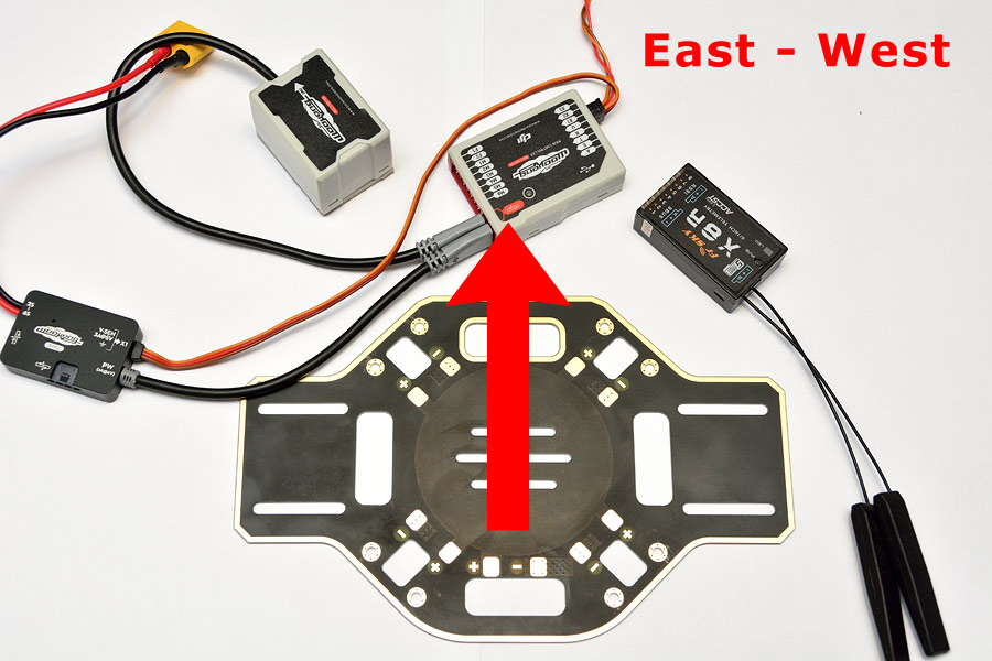

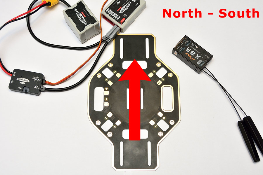

With installing a Wookong-M in mind, I am wondering which is the best way to orientate the Flamewheel F450 boards?
North-South or East-West configuration?
A picture is worth 1,000 words:
attachment.php
attachment.php
I intend to hang a mirrorless class camera beneath it, so the East-West favours that orientation. (the width of the camera bracket, and bolting that to the channels)
But North-South makes it easier for laying out the WKM & RX.
I have the internal clearance to sit the X8R RX on it's side as well.
Can anyone give pros and cons for either method please?

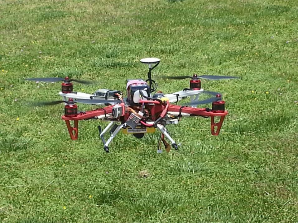

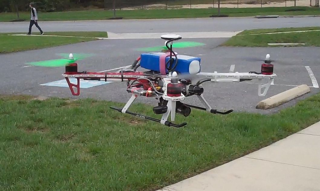

I laid mine out east/west to use the platforms as sort of outriggers to put things on plus I figured that way I wouldn't have anything overhanging the camera I use mounted underneath. Sometime later when I wanted to mount a GoPro I regretted not having it north/south but then I bought a Y6 as the primary video ship and I'm back to being happy the way it is.
Without OSD
attachment.php
With OSD
attachment.php

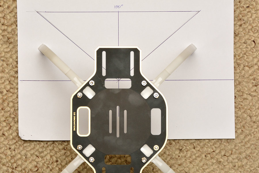

Being a camera barge, I should take into account the widest angle of view (100° in this case), and avoiding legs.
Then there are no tears or regrets later!
N-S.

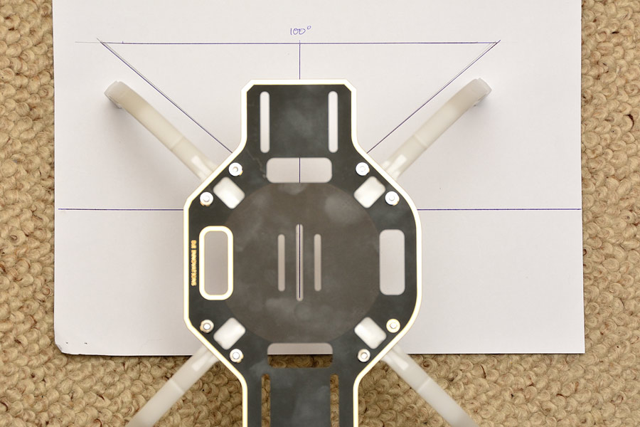

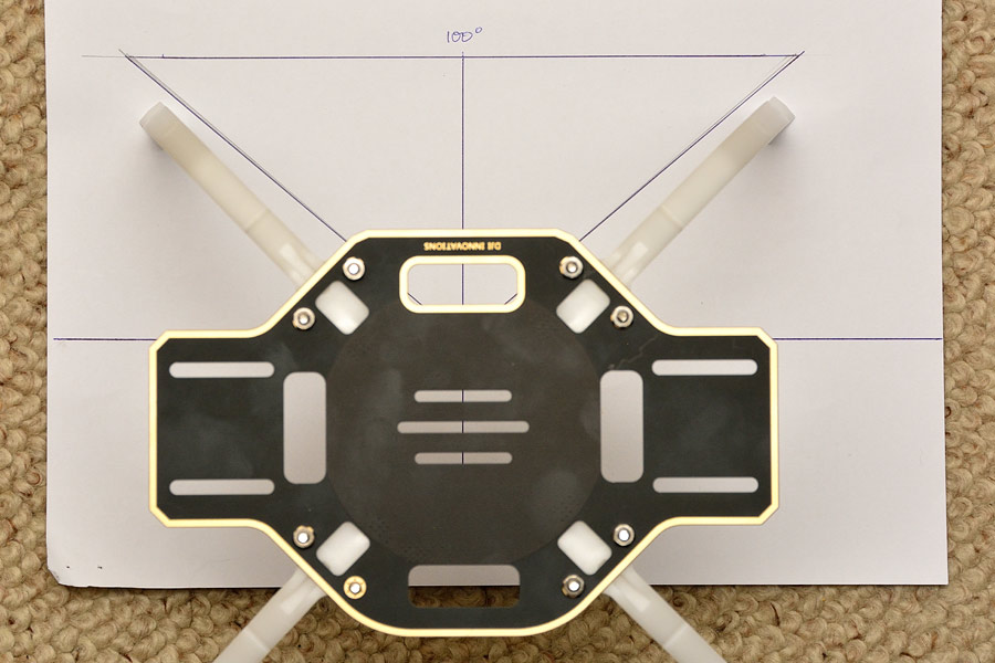

No convenient mounting holes directly under where the camera mount would be:
attachment.php
E-W:
Elongated mounting holes almost directly under where the camera mount would be:
attachment.php
N-S:
Camera needs to come forward to utilise elongated board mounting holes.
CG offset the most.
attachment.php

Obviously not a lot of interest here.
But, this video shows what I ended up doing:
