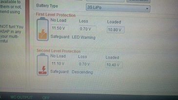

Thank you for your answer. I am attaching a screen shot of the voltage area of my software. Are you saying that these numbers should be changes and that this is the reason why I am only getting 3 minutes flight time?
As far as the leds. I get the green in GPS mode. But when I take off in the air seems like it will blink red at times, then maybe go back to green. It doesn't seem to stay green while in flight. Then of course after a few seconds here comes the flashing red and it's time to land again. :livid: I really hope you can help me!

Those loaded values are much higher than what I use.
I have 10.5v loaded first level, second level 9.5v loaded for my 3S batteries. I am not saying you should use what I use as everyone seems to have a different opinion of what they should be. Here is how I came about my values...
You should never let a cell drop below 3v. Most people will say that you shouldn't let them drop below 3.3v or 80% or whatever. At the end of the day it's up to you depending on how expensive your batteries are and how often you are willing to replace them.
So using the above as a guide I worked out 3v per cell, times that by 3 cells giving me 9v, add .5v for margin giving 9.5v, this is the loaded second level protection that I wanted to use and do not want my battery to get any lower than this. So in Naza Assistant I use second level no load = 10v, loss = .5v, giving me 9.5v loaded. If you want to be cautious with your batteries use 3.3v * 3 + margin = loaded.
For first level protection I added 1v. So 11v no load, .5v line loss, 10.5v loaded. Play with this all you want, at the end of the day this is just the warning LED telling you that juice is running low. You want to give yourself enough time to return home and land.
These settings have been working well for me so far. I am interested to see if anyone thinks my values are a bad idea actually.

I went ahead and set them to;
10.5v - 1st level
9.5 v - 2nd level
However it still hovered for 2 minutes then the red light was flashing again.

I have to agree with Hartz, looks like you have a bad pack since the 3rd cell is way low compared to the other two. Also I didn't see anyone mention anything about checking the calibration of your battery voltage in the assistant software. Mine was off enough to cause a premature low battery flashing light on the VU. I checked the voltage in the software and compared it to the actual battery voltage and they differed by quite a bit. You have to go into "calibrate battery voltage" in the software and input the actual voltage of your battery. Good luck.

The settings you suggest cannot be set for second level on V3.12 firmware, the lowest it will allow is 9.8V.
I have just reset mine to 10.6 and 10.1 with 0.5 for load and went out for a test and after hovering for about 5 seconds it flipped over, no damage but looks like a motor decided to let the smoke out at that specific time. Gaaaaarh!!!
