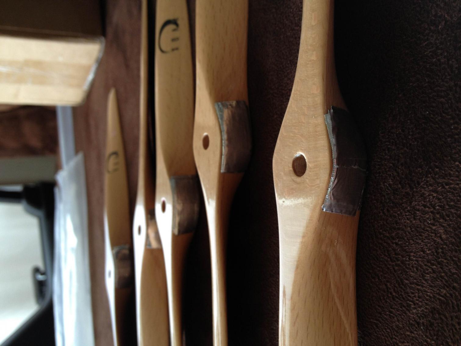

I spent over an hour balancing these things which all seem very out of balance! I know they are a natural product but having to do this much work on each prop makes me wonder if it is worth it. My question for the balancing pros is concerning the hub balancing. To start, I have a magnetic balancer and get the blade balanced perfectly horizontal in both directions. Once that is really close I tilt the blade 45 deg and get a feel for the heavy spot, which I am getting to be good at. The uncertainty comes with using to much aluminum tape to balance the hub. I have up to 10 1" layers of aluminum tape at the hub to get it balanced perfectly. Bart told me I am using too long of a piece of tape and they should be smaller to more precisely place the weight but I was concerned the tape wouldnt have enough surface area to adhere to the hub. One way or another if the blade is balanced on the balancer in such a way that it can hold in any position, am I good to go, or is there some negative side effect of having too much balance weight? Obviously this is more rotational mass but I would think it is negligible.

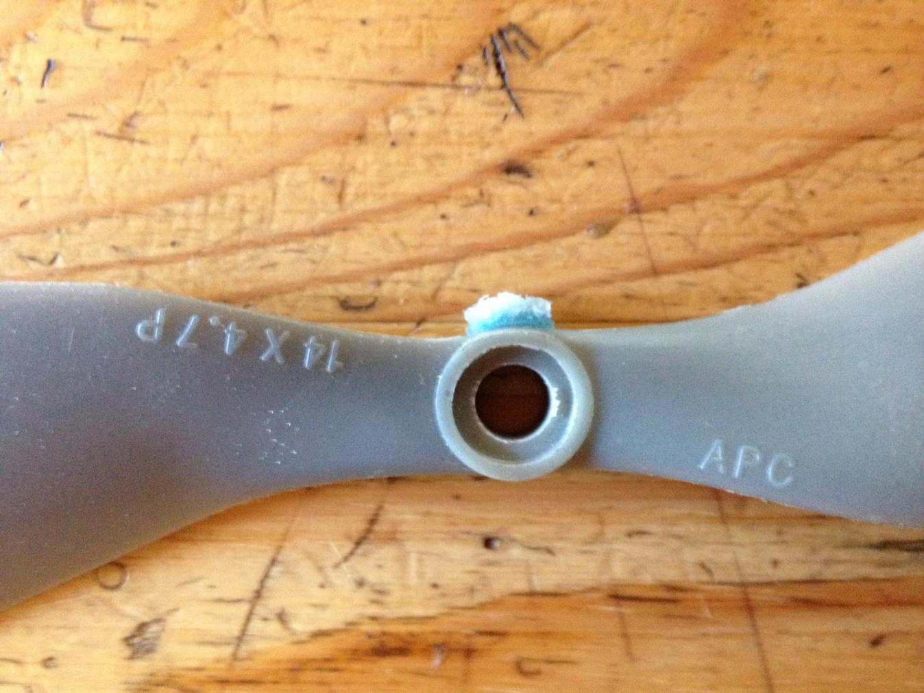

I am curious about the same thing but with my APC props. My 14x4.7 props all have huge amounts of Velcro/CA glue to balance the hug and the mass sticks out pretty far. I then feel like I get just as much, if not more vibration issues. I have had a really hard time balancing props lately. Almost like the quality control is taking a spiral downhill. Even though they show as balanced on the Du-bro balancer, sometimes they get bad vibration on spin-up. I did not know Xoars would need so much work! Also, it seems counter intuitive, but I wonder about the accuracy of these balancers.

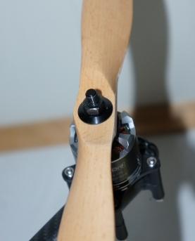

I balanced my Xoar 15x5 props and was surprised how much weight the hubs took so I added lead strip to the light side of the hubs just as is shown in the first post.
